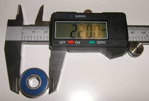

The diameter of your sway bar can be measured with a vernier caliper.

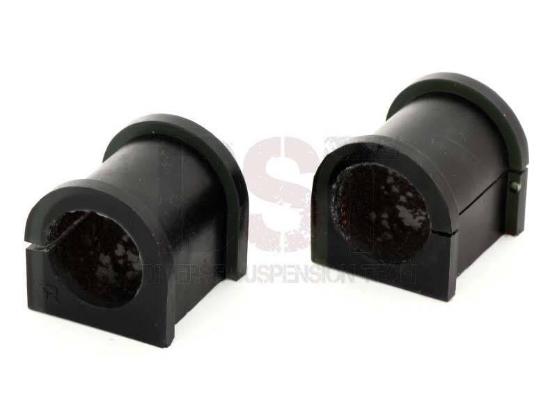

... How do I slide new polys on over over those flanges?
They have a split in them so you can open them and slide them over/around the bar, then the brackets goes back on and clamps it into place.
See the split ?
