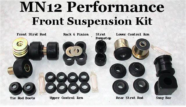

Does the mn12 polyeurathane bushing kit have a strut rod bushing with it? They have "rear strut rod" - is that the same thing?
how hard is it to replace a strut rod bushing?
If you look a lil closer you will see that it says that they have the 'front strut rod' bushings. The thing is the only part of that kit that is not poly is the rear strut rod bushings....they are factory rubber.

I am not sure....there is no pix there. I have the whole kit from MN12performance....sorry can not totally help.
I would just get the whole kit from MN12performance and install it. But if you are only going with the strut rod bushings call Max and order them from him (1-800-866-1520 ext.236)
