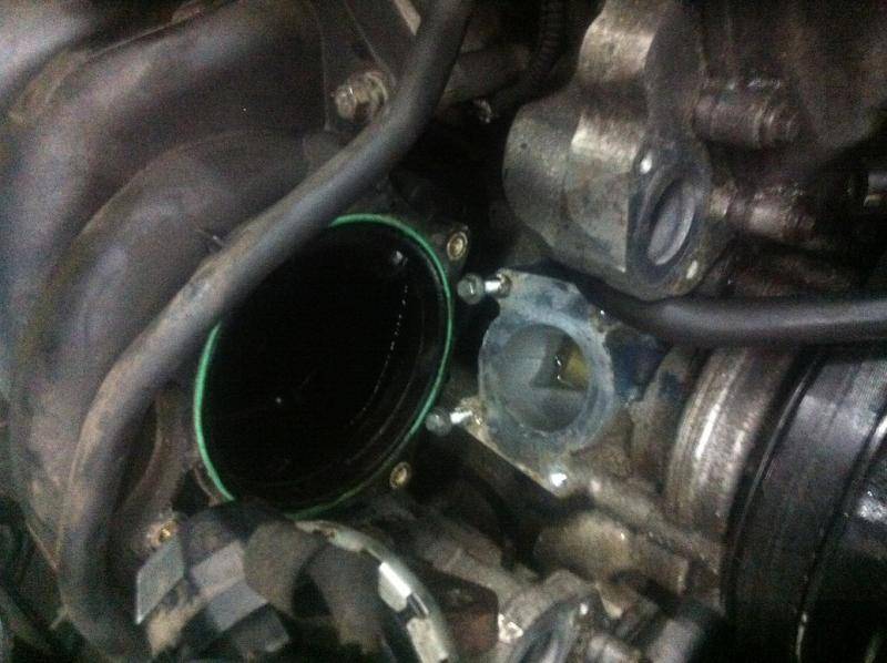

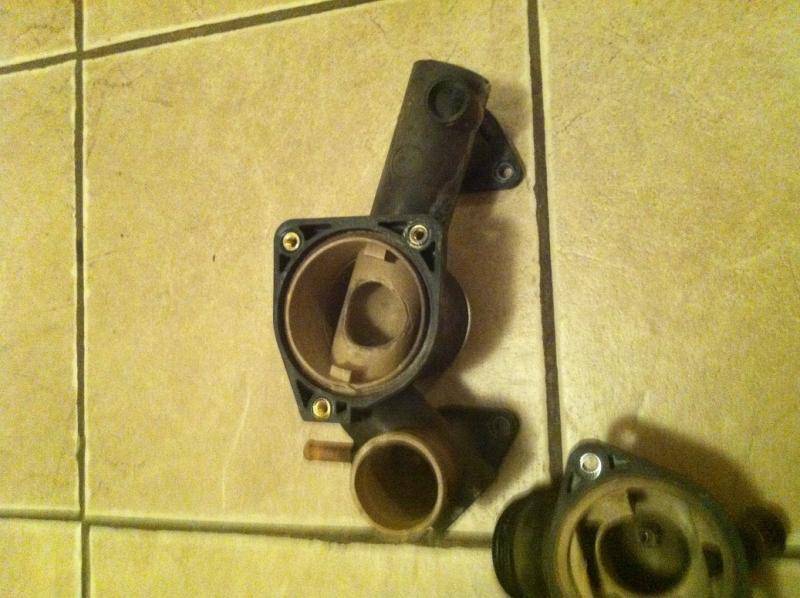

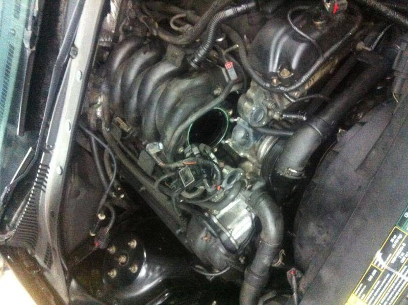

i just also did this myself ,at first i thought it was just the thermostat cuz it overheated so i got the tstat and some coolant from the stealership but when time came to install i noticed that the housing was rotted and broken then i noticed that the coolant outlet pipe was also very rotten looking and the small neck pipe behind that too so i changed out all 3 and all the o-rings ,cost me 400 in parts and a new belt ,i managed to get the 2 bolts that hold the last neck off without taking out the intake we had to cut the top of the bolts a bit to remove here are some pics .
