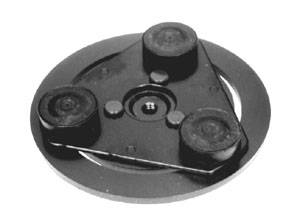

Does noise change when the clutch engages? Shut the car off, and see if the clutch "hub" is loose. It's the piece on the front of the clutch with the small bolt in the middle. Mine went on my old car and made alot of noise.
my98mark8: yes that is exactly the case.
Mike, come on over this weekend if you like, bring the compressor. Give me a call or pm thursday or friday to work out meeting time and place for this weekend. As far as the summer get together goes, I would love to, but the odds of me being able to get next friday off to go are very slim even if money isnt an issue.
