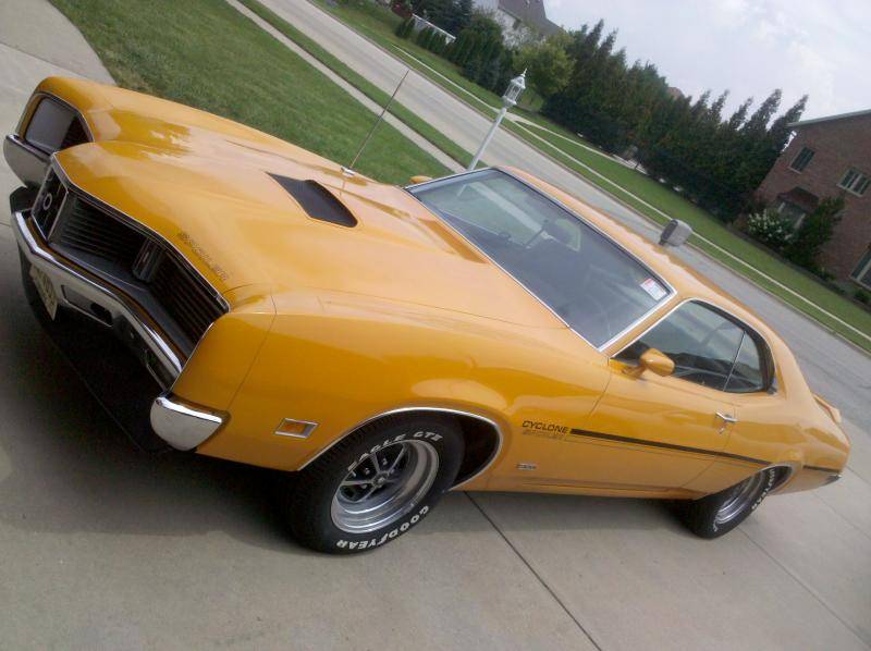

If you hadn't heard the story, I thought I blew a head gasket driving to the Boscobel meet. I was driving my 1970 Mercury Cyclone since I brought my Lincoln last year and it was a new car to me. I've been installing new parts and odds and ends since April in an attempt to make it more reliable but I gotta say driving 17 hours in a 40 year old car had me a bit worried.
