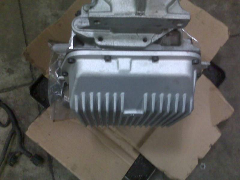

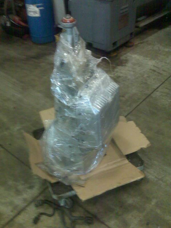

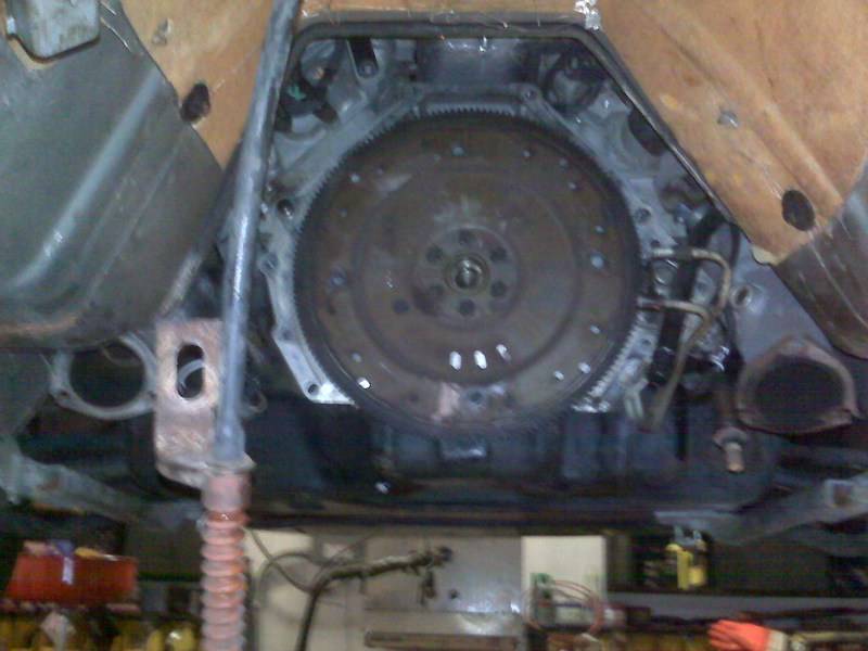

This tranny has served me well over the years, including putting up with abuse it takes to make a Mark VIII run a 13.4 second ET in the quarter mile. Well the time for all good things must come to an end, and this way it is under my terms. I spent part of the weekend with the car at a shop getting the tranny replaced.

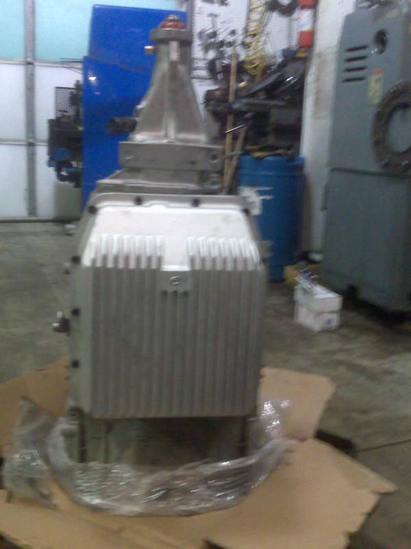

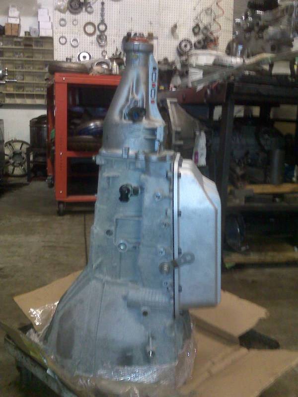

I went with a race-prepped tranny built for whatever I may decide to throw at it in the future.
It started with a late model case and J-modded valve body with all the 'good stuff' inside including the rear bushing lube mod and the extra large capacity cast aluminum pan.

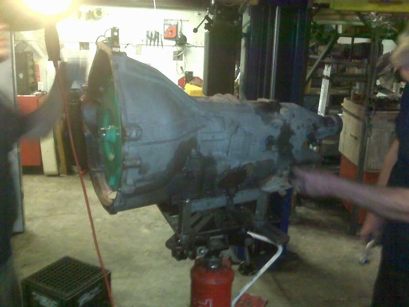

All in all though, I'm pleased and I'm sure once I get the lock-up working, it will be a good choice to have made. The old tranny showed some unusual findings in the autopsy, but no readily apparent serious malfunctions. The pan and fluid was spotless and some of the old '93 era internal parts were almost instant Smithsonian conversation pieces. Not bad for 138,000 miles and hundreds of track passes - considering this was supposedly the worst of the 4R70W trannies ever. Just goes to show what proper maintenance can do. :)
