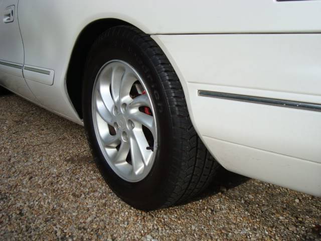

To prove what I'm saying, this pic was taken in Auburn and I had just had the tires balanced right before I went down there and look whats missing. A weight!

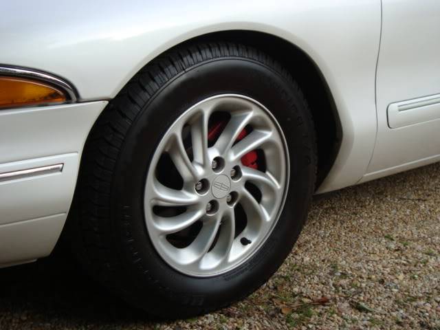

This tire held it's weight lol.

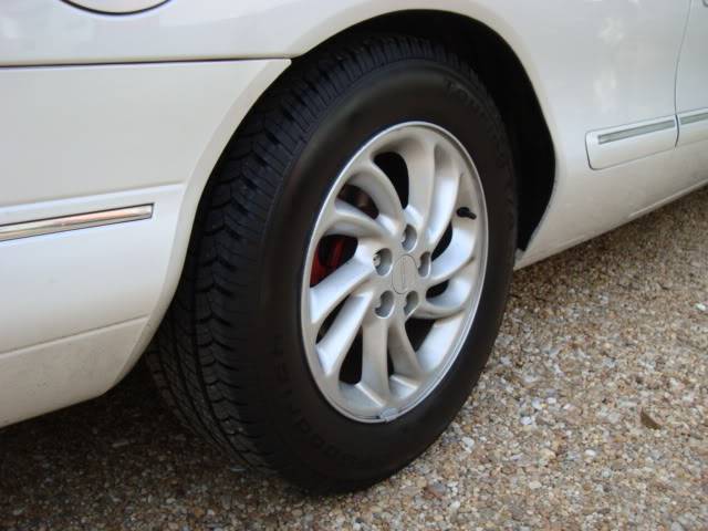

So did this one.
This was also before I got the new corner lenses. See the dirt build up in the yellow section?
