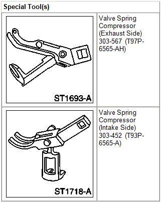

As for the springs, Comp also makes steel retainers (799-32) that are less than $100 for use with their 26123-32 springs. And you'll need two valve spring tools, they're different. I own them both, so I could rent them to you if need be. ;)

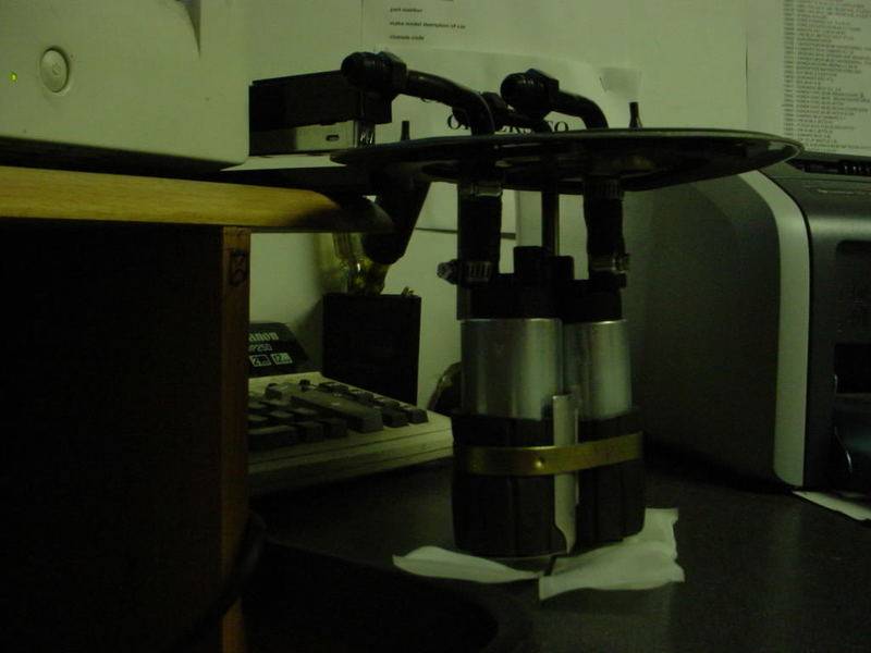

I modified the factory hanger to hold two pumps. Then I ran a second line out of the hanger and "Y" it into the factory fuel line. On the wiring side- I ran a new power wire to a new relay back by the tank then i used the Factory power wire as a trigger wire for the relay.

I make about 550+ at the crank and I run dual red Armstrong intanks now. I had two 255's one got unhooked during installation so I was doing alot of wide open pulls on one pump and never went lean till the gas level got really low. It takes a little customization on the fuel level sender and the slosh basket but it can be done. I think you can be safe at 400-450hp on one high pressure 255
I have two 12 gauge wires go to the pumps from the power block that runs the stereo. I use the old fuel pump power wire to trigger a relay to power the dual pumps

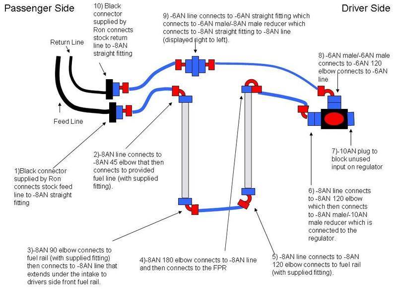

here are my pic's of my hose diagram I got rid of #9 an got straight to -8 back to the tank.

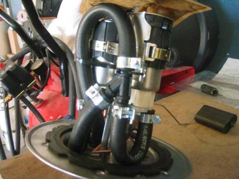

version 1.5 of intank hat (Dual -6 send -6 return)

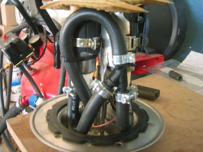

Version 2.7 of intank hat (single -10 send single -8 return)
