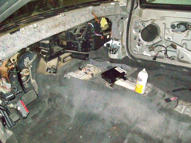

Today we took out the shifter, carpet, rear quarter plastic, seat belt retractors, rear dash carpet, headliner, and removed the interior door panels. The wiring harness inside the cabin is exposed... so we are thinking it is about time to remove the interior of the donor car and wrestle out the wiring harness. I best prep for pics, this should be interesting.

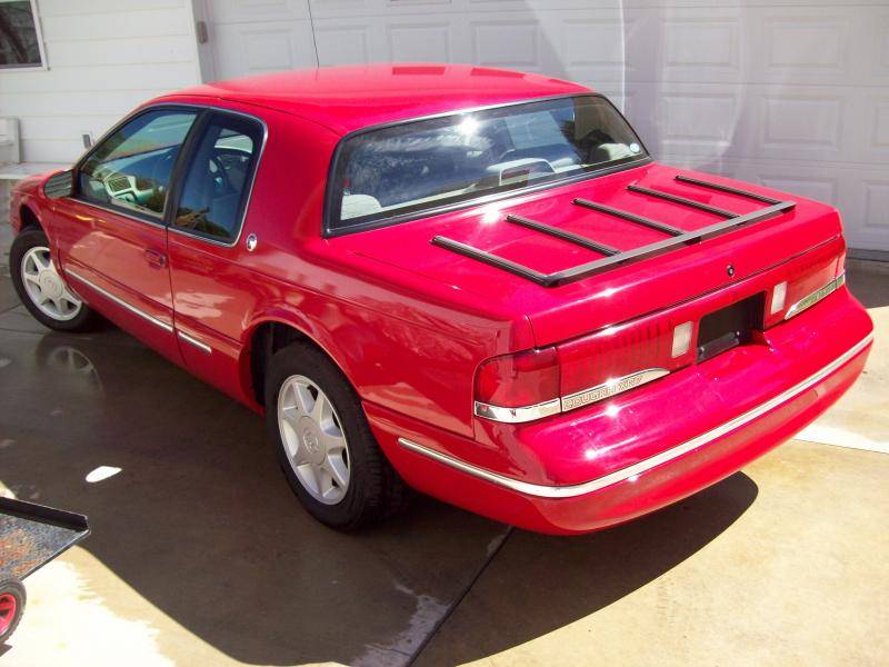

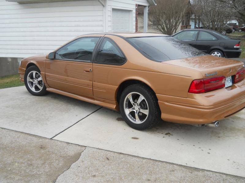

Here is the beneficiary

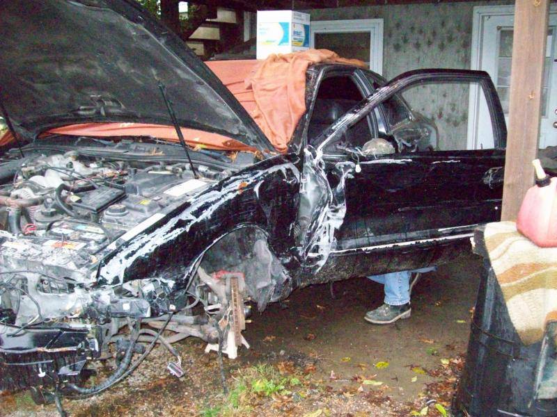

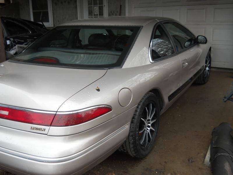

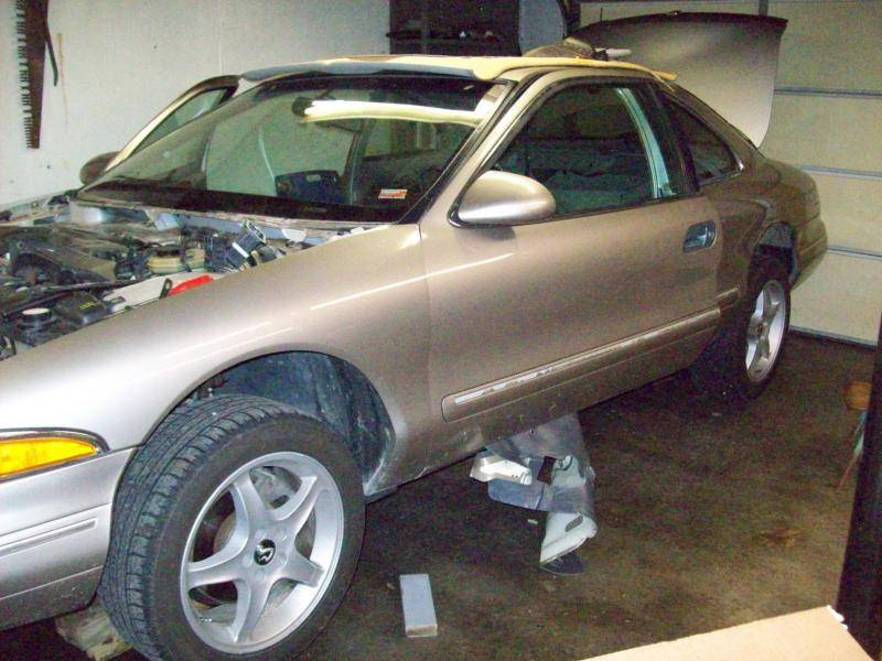

Here is the donor

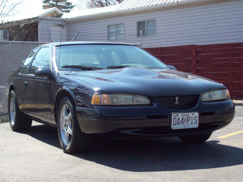

Here is a Cougar we slap with a 4.6 DOHC from a Mark and a Cobra intake.
He has 2 set of 17x7.5 and 17x9 to give the staggered look

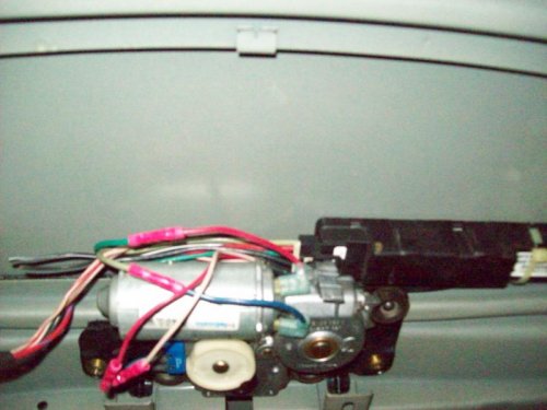

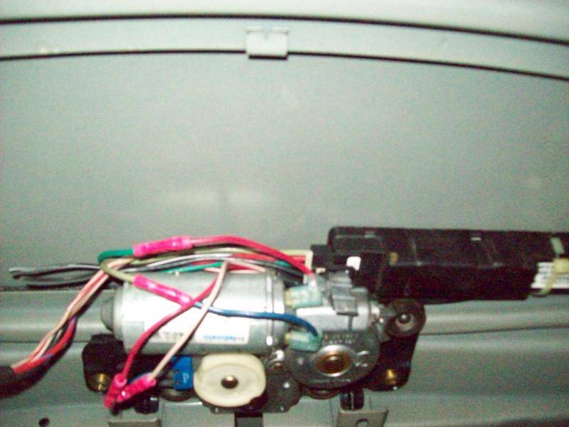

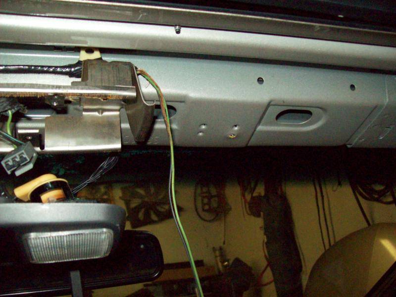

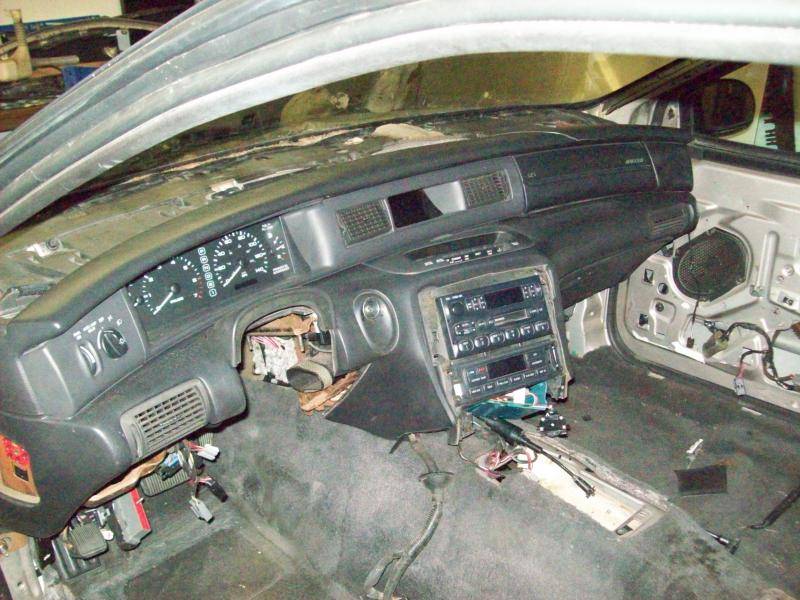

Today, we started breaking down the donor car. We got out the seats, quarter interior panels, rear deck carpet, sun visors and headliner. We found the the differences between 1st and second generation sunroofs and wiring. We kick it around for a bit and figured out how to blend in the first gen sunroof to 2nd gen wiring and make it a one touch opening. Two wires black and black with white stripe went to number 2 sensor trigger on the donor cars wiring, did not hook them anything.
We found a couple of bare wire at the sun roof to the sun visor. the donor car had been setting for a couple of month and the mice did not waste any time stripping wire 036.jpg

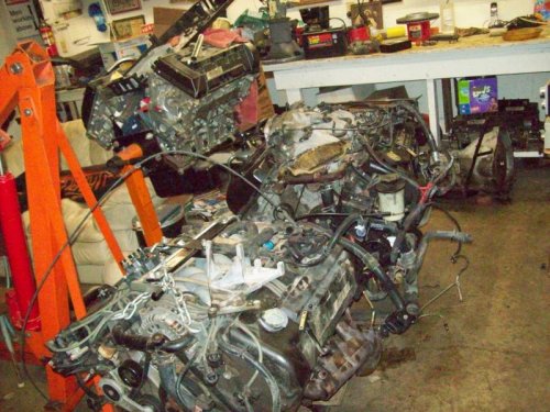

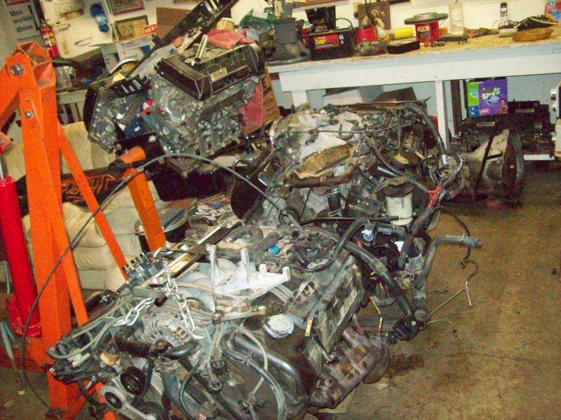

Can you really have to many TEKSID blocks?

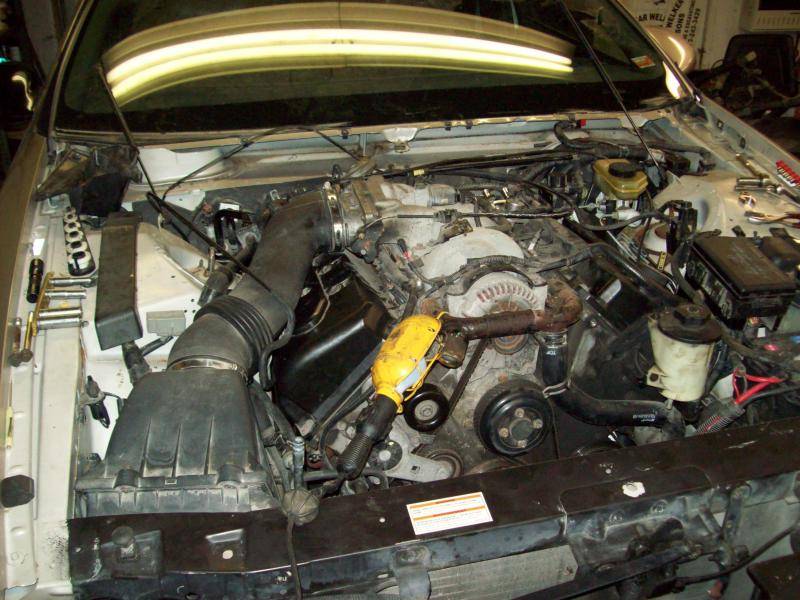

Here is the engine in its new home.

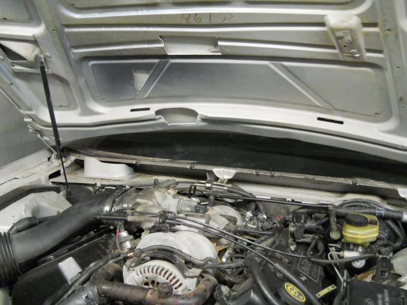

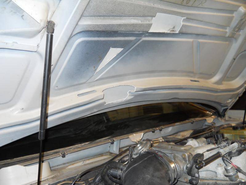

This is how close it is to put a gen2 engine in a gen1 body.
I suggested using body shims as an alternative, but here is where we are. Pretty tight, eh.

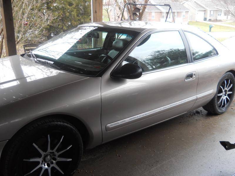

Crappy day for taken pics, but he had got the exterior clean.
What do you think of those wheels? I thought with the black molding and gen2 black mirrors it works.

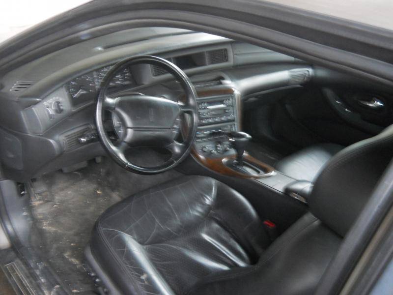

Ebony interior finally and heated seats are nice.
