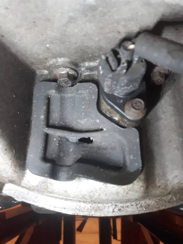

Anyone know where I can get one of these, had the car on a lift and saw this nice hole in the cover.
Junkyard.
That's not hurting anything, BTW.
Dang, you should skip the hole, and use the money for a cai. The cai would add some nice sound and power. Or instead you could buy a tuner and let me use it after.:D
And yes, I am not stuipid, a cai and tune would cost a lot more, but...... you should consider it. I mean, the hole is not visible during normal driving. But the knowledge could still be annoying.
That seems to be a weak spot in that cover. I've seen others with pretty much the same hole.
If it is not oil soaked, silicone will work to plug the hole. This part is hard to obtain. I made one from 1/8 foam semi-stiff board cover in Permatex 650°F silicone. Scissors and a quarter square foot . Use the original as a guide to layering the pieces and trim to fit. be patient
