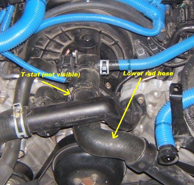

Does n e one know where the thermostat is on an 01 LS with the V8 i have to change mine but would like to know for sure where it is. N e pics would be help full too thankx in advanced
the t-stat is located in the cooler tower housing, attached at the end of the lower rad hose. it's held on with three 8mm bolts.
Thanks for the pics Quik Ls very help full it should be a breeze now that i know where it is for sure.
