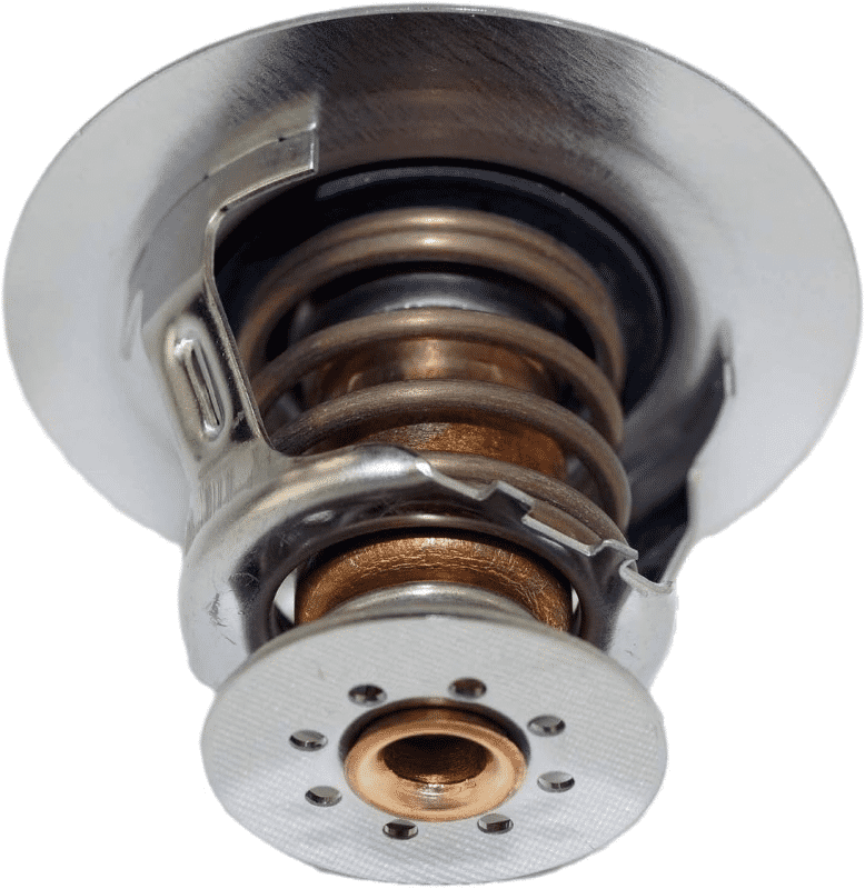

I checked RockAuto. They're out of the aircraft-grade aluminum thermostat housing upgrade, which I was going to recommend (you would find that under the 2000 Jaguar S-type). The motorcraft part listed for the LS V8 thermostat is RT1154 and has the flat bottom, like the second picture.

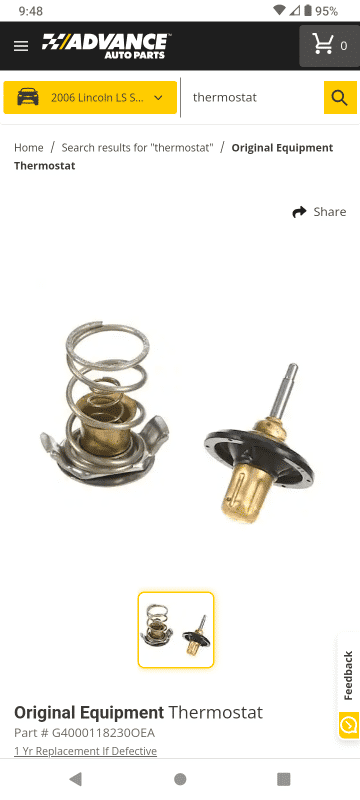

@rgorke the pic won't let you see the bottom but this is the thermostat i use in my 06 LS and it's never give me a problem. The OE Motorcraft thermostat was binding itself off when attempting to open. Mine would cycle open sometimes and sometimes it wouldn't cycle at all. Thats why i installed the one in the picture, it has plenty of clearance and will not bind up.
