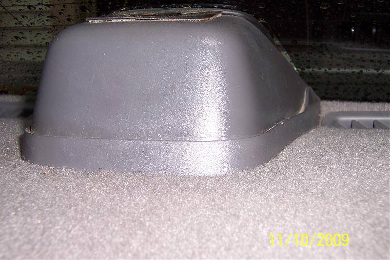

Anwyays....question. The brake light housing has what appears to be some sort of separate "base" at the bottom that surrounds the actual housing. This "base" is the same plastic color as the housing but is clearly a separate part. When I press down and pull, am I to assume that entire plastic assembly..both parts, slide backward, including the "base" that I describe?
Only the upper portion of the housing will slide backward when pushing down on the top of the housing. This is a gen1 right

Yes, its a gen 1. So if I push down, Im guessing Im going to have to lift up a bit on the portion closest to the front of the car, in order to clear that base/lip at the bottom. Correct?

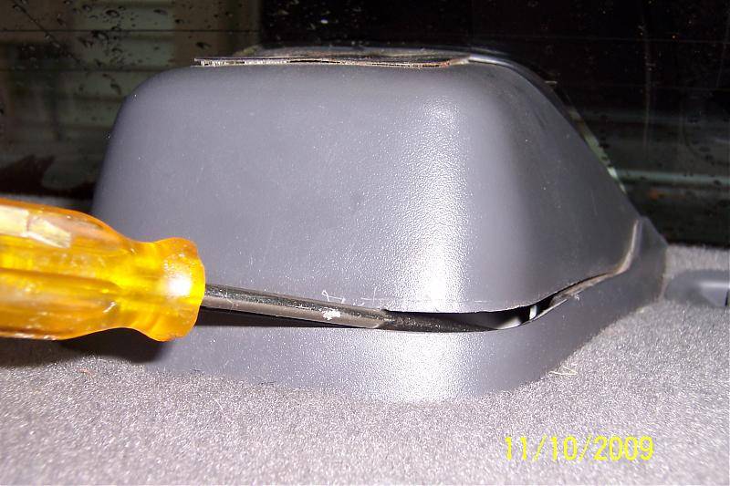

Here is what mine looks like. Im I supposed to push down and pull towards the seat this ENTIRE assembly? Or just the cover part that Im lifting up with the screwdriver? And do I pry up that cover and then pull back? Obviously I cant just pull back the cover with it resting down in the base?
Help!
in that second pic, I cant get the cover up any higher than that, as its attached to the base up front closest to the rear window. I cant see how its attached, but can tell that if I keep prying much harder, Im sure SOMETHING is going to break/snap.
You push down on that whole assy and pull, no screwdriver should be used unless you want to break it off lol
Im starting to think different years of first gen LS's have different methods of getting to that bulb. I went back up and pressed HARD downward on that assembly and pulled and tug. Nothing.

In all the 00-02 LS's I've come across yours is the first with that style brake lamp w/ the bottom base, my guess is they had different one for the Alpine sound system. Here are a few pic's of what was used on my 00LS V-8 w/the Alpine system in the rear deck. If you press down on the trim cover near the front(where my pic shows the 1st of the 3 side tabs then pull straight back maybe it will release the same as this style lamp.
thanks. FYI..I do have the Alpine System as well.2002 LSE V8.
I'll go back out and try again, focusing on the front part to slide back..but as you can see, the base is kinda in the way for a push down/slide method
No dice. Not budging. That base is truly in the way. And its a catch22. The Service CD has a step in the process that says to remove the cover, in order to remove the whole assembly. But it doesnt give any detail in how to remove the cover. Thanks to your pics, I can easily see how sliding the cover straight back while pressing down would work if I didnt have that base. But the fact is..I do, have the base.
