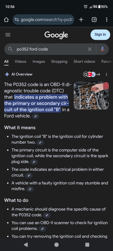

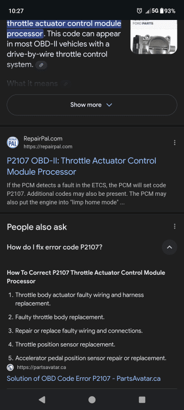

About a week ago my throttle body went out so I bought a used one and I work fine for about a day now I have these 3 codes it'll crank up and run really good for about 3 seconds then it goes into etc failsafe mode... I just put new 8 ignition coils and spark plugs p2107
P0352
P2100
If the vehicle has the original coils (or cheap coils) it would be best to buy new ones. The 3.9 is very finicky about coils as they age.
You could buy one and see if that helps, but that also means that the rest will need replacement at some point.
