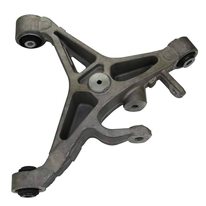

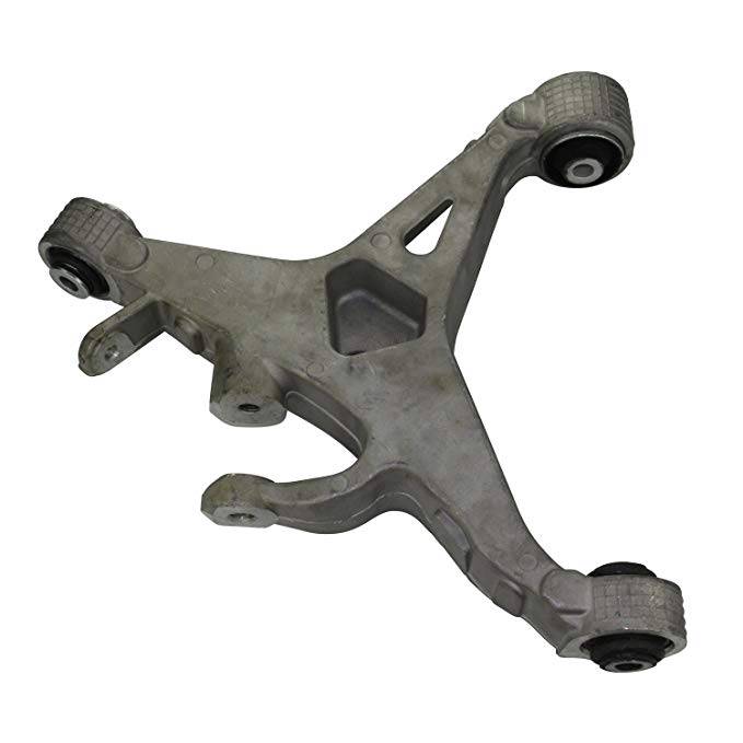

Are the front and rear outer tie rods the same or are they different part numbers what I mean is will a front left work on rear left and front right work on rear right? Just trying to make sure I am grabbing the right thing. I just ordered Moog Lower Rear Control Arms and was replacing the suspension parts when my gas tank has to be dropped to fix my fuel tank pressure sensor. It seems to get to the harness the tank has to be dropped anyway so might as well get this stuff done at the same time. I think the upper control arms have been replaced but I will take a 2nd look in the morning. I know for sure the front upper ones have as they are Jaguar OEM. And if I am not mistaken the rear was the same way when I saw it on a lift.
