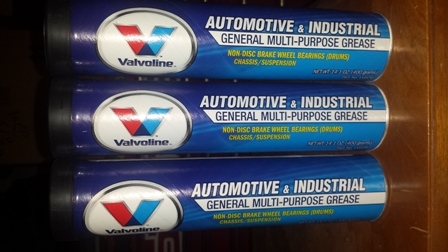

If you decide to order Moog tie rods and BJ's - let me know if you receive any guidance on what grease to use for the "problemsolver" parts. I got all my stuff from rockauto and the instructions dont say anything about greasing them before install/first drive, or what grease to use. I have all my stuff on the car, but haven't driven it because I just got a grease gun today.
Grease is grease, honestly.
Blue stuff should keep it happy all around.
