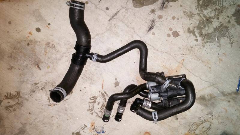

Well that was every bit as unpleasant as others have said. I had intended to clamp hoses so as not to have to drain the radiator. Then I opened the hood. With that upper radiator hose where it is, I couldn't get at the auxiliary pump let alone the DCCV. The only way I could see to do it without losing my sanity was to start removing hoses, which meant draining the radiator.
I also read the tips about not using the quick-disconnect couplings on 3 of the 5 hoses, but even with the fancy cable-based hose-clamp pliers, I realized that trying to remove all 5 hoses at the DCCV was going to be incredibly difficult.
So I disconnected the upper radiator hose at both ends. It has a T that runs to the DCCV so that also served the purpose of freeing up hose 1 of 5. With that out of the way, the aux pump is very easy to dislodge with two bolts. Lifting it up and out of the way also makes it easy to remove hose 2 of 5, which runs from the DCCV to the aux pump. That left the other three hoses, which have the quick disconnects. Even at this point, there was too much stuff in the way for me to be able to get at the hose clamps on the DCCV side, so I just took my chances and quick disconnected them.
A note about the quick disconnects: For each of the upper two fittings, there are two o-ring gaskets that sandwich an amber plastic spacer ring. These plastic rings tended to slide off. I bet that failure to notice theses things or put them back on could result in leaking.
Anyway, with all those connections undone, it was just a matter of unbolting, removing the electrical connector, and maneuvering the thing out of its cavity.
Here it is in its liberated state:
While I had it out I went ahead and replaced the front sway bar bushings, which was its own adventure. After putting everything back together, I went through the coolant fill and bleed procedure. Everything seems to be working great again, and I have my A/C back!
