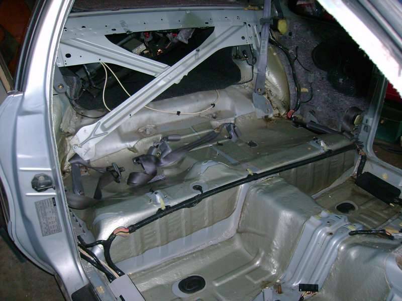

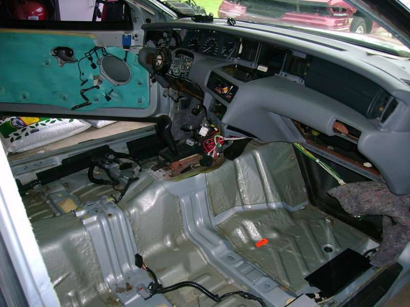

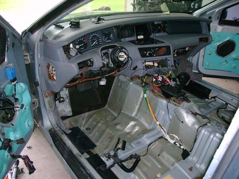

I like trying thinks that hasn't been done before. Or at least I think it hasn't been done. It's been talked about, but most discouraged. It's been described as a PITA project, it's been said that it can't be done. :shifty::shifty: Really?? Well, I have nothing but time and a boatload of patience. What am I talking about? I am talking about Gen2 everything interior into a Gen1. Why do it? Why not. I have a complete Gen2 sitting there. So I am going to do it. I've been studying this for the past week, and the way I am going to tackle this is to:
  • Completely remove the Gen 1 interior.
  • Completely remove the gen2 interior.
  • Take the complete wiring harness from the Gen 2 and transplant it to the Gen1.
  • Swap over AC Box and anything else that is different on the Gen2.
This project is very doable. I think I'm in a unique situation than most, because I already have everything.
