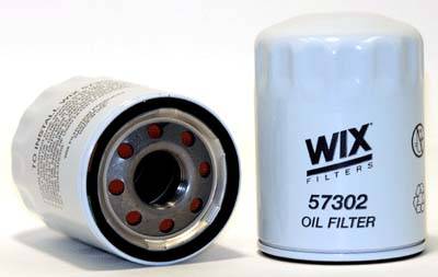

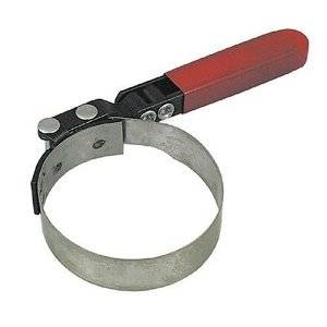

And, the only "special" filter it needs is a Wix 57302. It's "special" because out of all the different oil filters Wix sells it's the only one that fits on the LS. Side screw, right under the engine where it's easy to get at. If you have ramps, an oil change pan, a compression style oil filter wrench and a half hour you can change it yourself.
