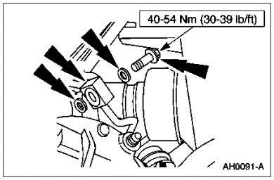

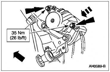

For a 1997 Lincoln Mark VIII, are there any torque specifications for tightening the brake bolts on the caliper bracket, caliper and brake hose ?
Use lock tight on the bolts holding the bracket to upright. I always use my 1/2 impact for those 2, the bolts holding the caliper to bracket I just make sure they're snug with a 3/8 drive ratchet.
The banjo bolt holding the hose to caliper is hollow, do not use brute force to tighten this one. Just tight enough so that it doesn't leak brake fluid
What the 97 Mark VIII manual says for all bolts around the front brake area.
