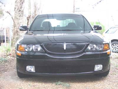

Had some warm days here and completed the project. Took a picture and, of course, my photography skills are right up there with my paint skills. Here's a shot anyway. I've been using Duplicolor Black Spray, along with their clear coat. After a couple of small projects with it, I'm considering shooting my front bumper cover. I'm sure it would turn out better than it looks now with all the little dings and perma-bug marks that 70K miles have put on it.

That looks pretty good. Did you get that lower grille from an LLSOC member?

Yep. Ron G. got it from Chris and never took it out of the box. Chris drew the template on the inside of the box, smart guy that he is, so I just made some minor adjustments with my dremmel, after I cut the piece down. It was from that original batch of ten, from way back when. It might be worth checking into , as an LSK item. Not sure how big the market is for them. (It would probably be a good idea to cut them down to the template size and let the buyer make final adjustments.)
