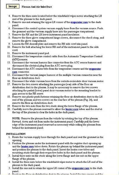

i have an 89 lincoln town car and the heater core needs to be replaced. Im told that to take the dash board out that you have to remove the windshield. Is this true? I just wanna know what i'm getting in to. Thanx
No. Pretty straight forward when I had to change it out on my 87.
Below is taken out from AllData to give you an idea of what has to be done.
