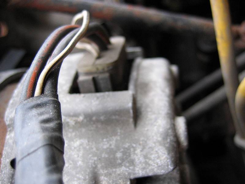

If you're not throwing any codes, your sensors are all within design parameters. Try the battery/alt. route first(ie. having it all checked). You could also try disconnecting the battery and cleaning the terminals (leave disconnected for at least a minute). Also, check all your ground wires. Then do a 'drive cycle' to let the ECM re-learn your driving habits. (At least 5 miles of highway and stop and go driving). If you have an overnight drain, you have a definite problem. Also, the alt. connectors are prone to meltdown. I would replace it just for peace of mind at this point.
