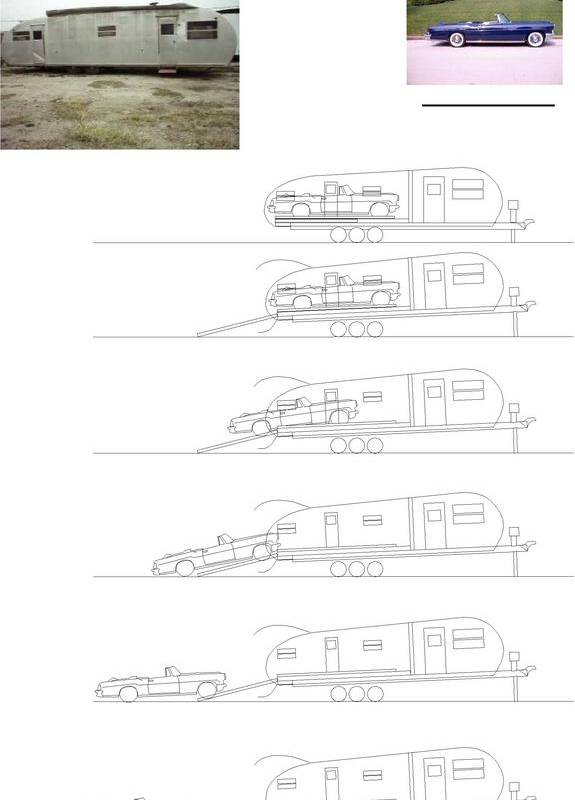

Monster Garage trailer project. Watch this 1951 35-foot aluminum travel trailer be converted into a toybox. There will be 21 feet of garage space in the back and an air conditioned lounge with a bathroom up front.
The trailer will tip up in the front when the air pressure to the two rear axles is reduced. There will be an electric jack in the front to stabilize the trailer for loading and unloading.
The trailer is too narrow to get out of the car after loading so the car will be winched into the trailer in tracks set for the width of the car. When the trailer tips up 5° the weight of the car will pull it out of the trailer controlled by paying out the winch.
