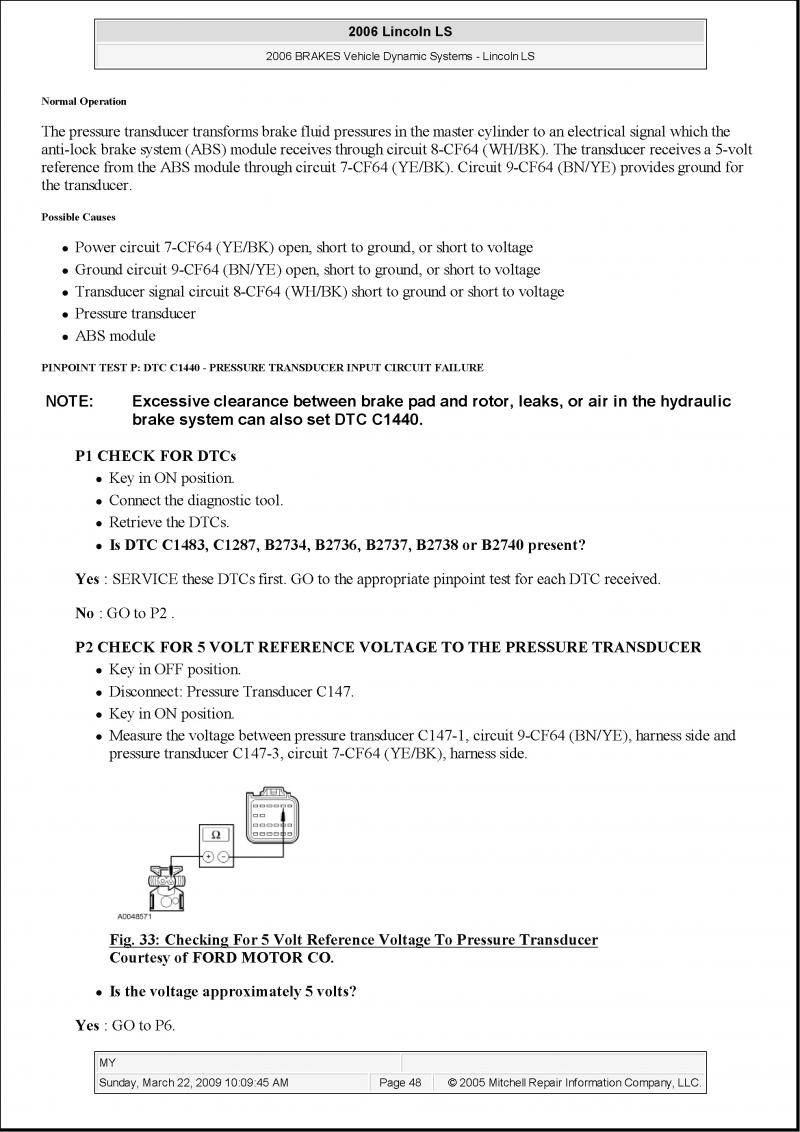

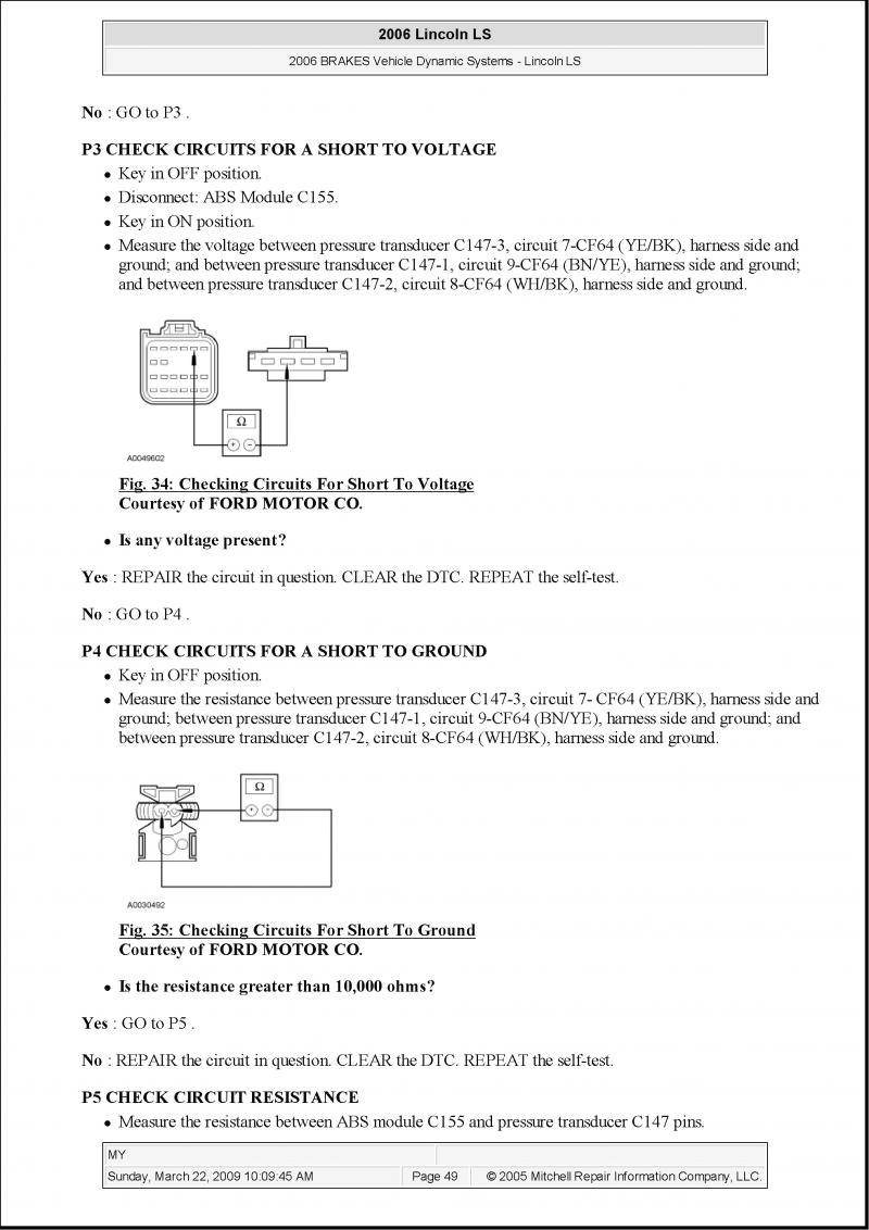

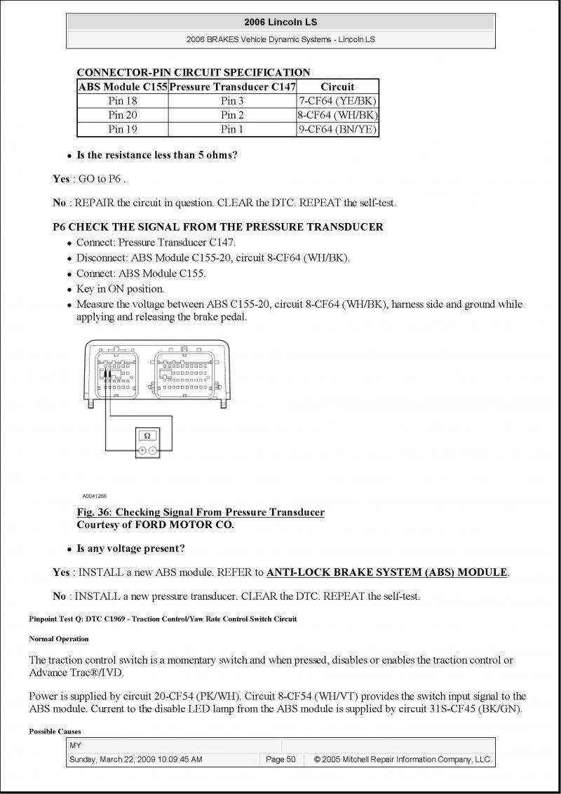

C1440 (If you take care of this one, the other one may be related and may go away.) Do note the warning that you must verify that you don't have any mechanical or hydraulic brake problems first.
Ok I saw online somewhere it said there was a part that goes bad that takes like 5 minutes to replace is that the transducer signal circuit 8-CF54? I have all these parts in stock already should I just go with the throw it on and see if it works method? What's wrong with most people's LS when these lights come on if you happen to know? Thanks joe
Most the the time if only the AdvanceTrac light comes on and the ABS light stays off, it is the steering wheel angle sensor. Apparently not so for you. Why throw parts at it? Why not follow the quick and simple troubling shooting procedure above?
(It would take me well over five minutes to bleed the brakes after replacing the pressure sensor, probably at least an hour to get all four correctly.)

Maybe, but he has a code for a hydraulic brake pressure sensor and not any other. To replace the sensor he has a code for, bleeding is involved. To replace any other sensor he doesn't have a code for would seem silly. Of course, it seemed strange for him to ask about the most common issues when he already knows what area his issue is in and what to do to narrow it down to the sensor, the wiring, the ABS electronics module, or a mechanical issue with the brakes. I guess diagnosis is not as well regarded as I would have hoped.

I would start with "Excessive clearance between the brake pad and rotor, leaks, or air in the hydraulic brake system can also set DTC C1440" since you could have damaged something when you were doing that.
Alright I think air in the system is likley. When I had the car fixed the abs sensor had to be replaced and the brake line. When it was fixed only the front brakes were bleeded if I remember right. It doesn't seem to be affecting anything but I'll get it checked out soon and update ya guys. And if it had excessive clearance would that be a caliper issue?
