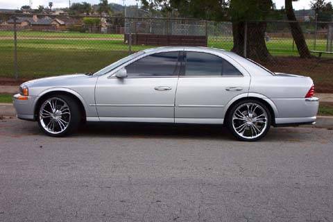

rims are a bit of a pain to find. The lignut pattern is unique in this car. You will be looking for a FWD offset even though its a RWD car. Also any bigger then 8.5" wide and it will stick out. Look for rims that have a center hub cap where you can't see the lug nuts because most likely its covered because the rims are intended to be drilled to custom fit the lug pattern. I got my rims and tires for $2000 from a local shop here in socal called Salenas tires. After a week or so with them i realized that my friend worked there and i could have gotten them at cost. oh well. hope this helpes. BTW some people think that 20"s are too big for this car, I disagree but heres a picture of mine.
20"x8.5" ICE by lexani(icemetal).
