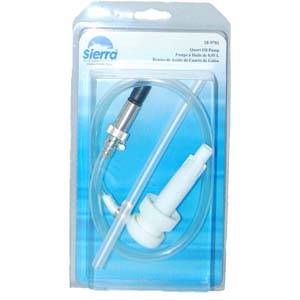

Anybody use this before to add or change ATF in tranny?
Not me, but it does look like it should work. As long as the end tip is small enough to fit in the fill hole
Probably will work to add. Won't work to remove fluid. What looks like a drain plug, is NOT. It is an inspection port with a tube going up into the tranny pan. The open end of the tube is several inches up. WHen the fluid level is correct, some will go above the end of the tube and dribble out. To drain the pan, I think the only home method is to drop the pan, which I would do anyway so I could inspect the pan for problems.
This is one of those trannies where it may just be better to pay the cost of a tranny flush rather than do it at home. Unless you like dropping the pan, I do.
BTW, I have used these hand pump type deals since the 70s. Work great on ATF and OK with thick differential fluid. Thick fluids are a pita to pump since it takes a fair amount of pressure to pump the handle and you might get a cramp after several bottles.
