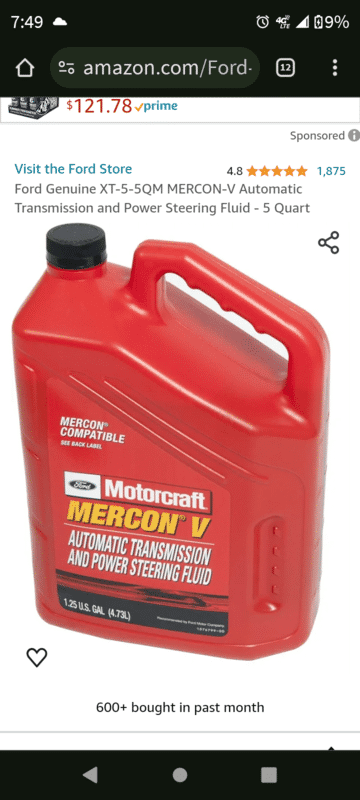

I called my local dealerships I’m in Modesto ca, they all will do it for a charge of 350$ but when I ask them the procedure they don’t say anything about the machine, their procedure is to just drop the pan, guess I’ll just have to do it myself, to double check the fluid is “motorcraft mercon v”
THIS Stuff right??
