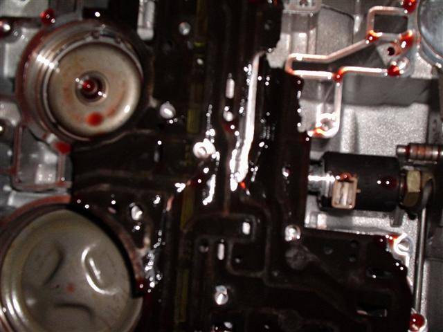

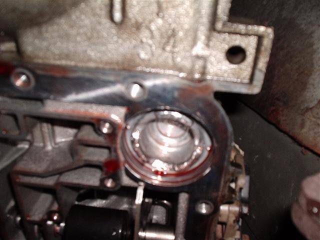

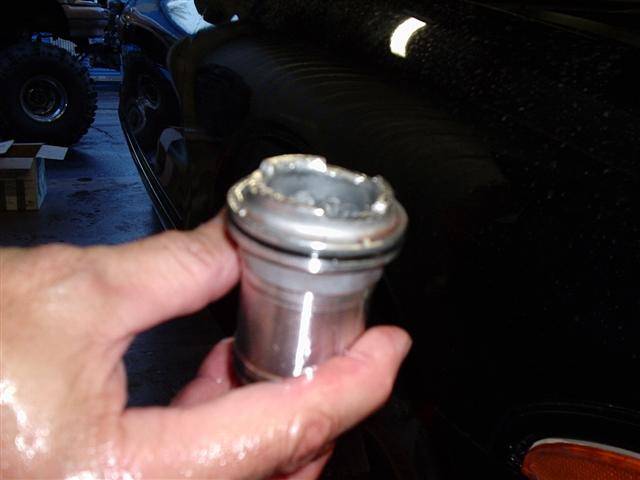

I'm done, well the car is still in piece’s but i just got a*s raped by the guys who rebuilt it in GA, when i removed the tranny pan i saw that the filter had rust on it( now how dose that happen in side a tranny full of fluid) also the valve body gasket was reused, it was stuck on there and bent out of shape . it was not even in there right position. so got that off started to take my 1-2 accumulator off when i got the piston out the other side was beat to sh*t ( you would think that if a part was damaged you should replace it) i got pictures of it. i just stopped and came home after that, now they told me that they replaced every thing that should be .it wasn’t when i opened it up. there is still a month left on the warranty (been driving it for two) so any advise is welcomed, im thinking parking the car and biking every where i have to go , cuz i don’t have any money to fix this

well i started to take out the tranny and guess what 3 out of the 8 bolts where lose, hmmmm, what good work guys performed on my tranny
