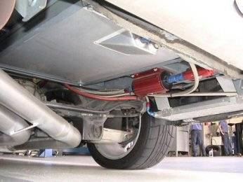

OK I already have a trans cooler but since Im getting a 3500 stall I want to make sure a have more then enough cooling capablitly, So I want to get a decent size cooler and a high CFM fan and install in the back. also whats the best way to get power to the fan, and if you know how to but those ends on steel braided hose could you explain
heres a pic to show you want im thinking
Those hose ends are Billet AN. Availble from summit, or any Speed shop thats worth a damn. And you need to make sure to put a thermostat in the tranny cooler system. You want the fluid to be "cool" but not TOO cool.
