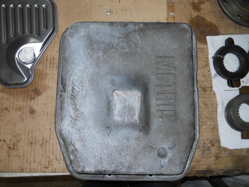

Do you have the "dimple" trans pan?
I have the stock pan as far as i know. I am not sure what the dimple transpan is actually

This is a dimple pan.
For some reason I want to say yes. I will have to double check on the weekend. if i do is there something i should cautious of ?
What year is your car? The non dimple pan will neutral out on right turns. You want the dimple pan.
