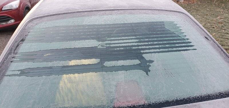

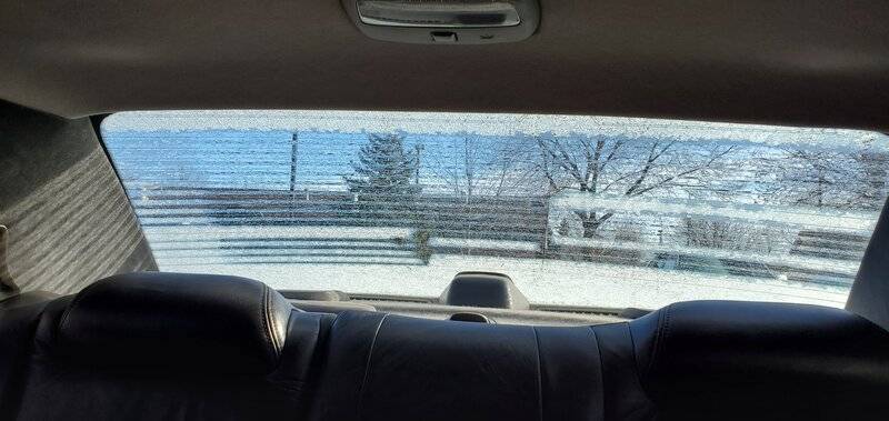

My rear defogger has segments that to not heat and subsequently do no defrost/defog the rear window. I decided to tackle this today A visual inspection showed no breaks in the grid lines. I ran a multi meter from the drivers side power tab and checked continuity across the grid to find breaks. There were no breaks found. Zero ohms across the entire grid. I am not seeing where the issue may be. I do have the grid repair kit with the the small bottle of conductive paint if I can find the breaks. Does anyone have any thoughts as to troubleshooting this or what I am up against here?
not sure but I would get a magnifying glass and put on the rear defrost when its iced up, and inspect each start and end of non working lines, is there 12v at the connector?
Power is there and is not the issue. The various segments are not working. I think I need to try checking continuity on the individual segments. I am trying to get this fixed before I get the windows tinted. 90 degree weather right now so not really frosting up, even here in Minnesota.
