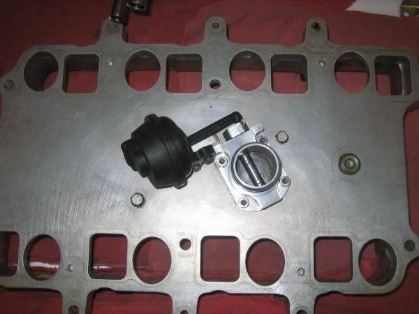

I was posted a link in another thread of mine for some guy selling a KB 2.2L 96-98 Cobra kit. I decided to bite the bullet and try and buy it. The thing has 8K on it and is the 2.2L not the standard 2.1L kit. The problem is because he has the bypass valve on the bottom of the plenum it looks like there is a 1" spacer under the plenum which takes space I dont have. :(
Searching through threads it seems I already need to drop the k-member an inch to clear the standard setup. Since there are no cowl hoods for the second Gens I assume I am just SOL on this blower.

Here is his setup:

THese are not spacers, these are oem IMRC plates, same as on your engine. Looks like a typical B head install.
You're gonna have issues close to the cowl though, as it won't clear the hood.

Dropping the K will take care of these issues correct?

Yeah I just a few minutes ago found that out. I assumed they were spacers so maybe I can still use the bypass valve.
Just spoke to KB and he said the valve can be removed if I am running under 9psi but that was when I told them I thought there were spacers under the KB plenum.

So the question now is what to use for spacers.
