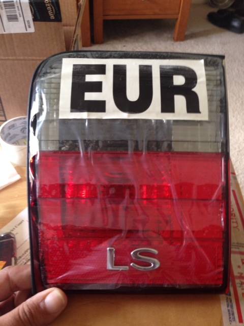

I don't believe so. But there were some tail lights and license plate surrounds made for Europe. They look just like the GEN1 2 tone tails except there is the reverse lights in the trunk mounted tail lamp assemblies due to the European plate surround didn't include the reverse lights. I'm looking for the left hand side Euro trunk mounted tail light. I have the right one already.
I have already contacted Ford and Lincoln directly. They provided the contact info for 2 companies that manufacture parts for Ford that are no longer in production or in stock, with no luck.
For your viewing pleasure:

Huh. I've never seen that license surround. I've only seen the one with the one white and one red lens (intended as a rear fog).
When I went to my parts guys with the numbers for the Euro LS light pictured, he just said "I don't recognize that at all and have no idea where to look beyond a search for that number"
Expected, but still a little disheartening. I also have the single Euro light. I only occasionally look for the other one. I have 2 Gen 2 outers so I'd like to complete the two tone look.
Interesting, must be to take into account their extra long license tags. I'll bet there's an option to turn on the left hand tail light as well, as they (at least in Germany) require that you leave a tail light on when parking on the street at night instead of just depending upon a reflector. At least, that's the way it was when I was over there. They just had a single 194 sized bulb in there. This would mean that the headlight switch would have an extra button or switch on it for this purpose.

When I went to my parts guys with the numbers for the Euro LS light pictured, he just said "I don't recognize that at all and have no idea where to look beyond a search for that number".
When I contacted the one company they kept saying it is only marked in description as a reverse light but pictured as the one in the rear surround. Super strange. Maybe there isn't a left side? Possible that the left side would have been one of the JDM two tone tails?
Meanwhile ... Alex could easily makes us some two tone inner lenses that could be glued in.
