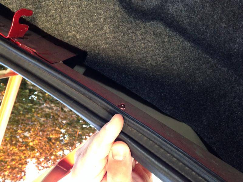

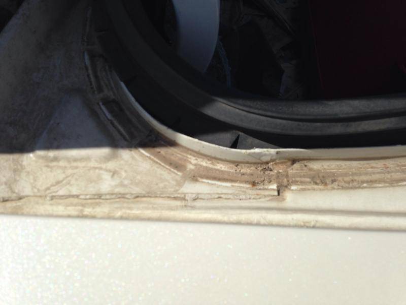

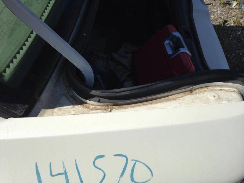

Thanks again, everyone, for their input. This thread has kinda gotten into the trunk leak issue, so I thought I'd post some pics of what I found.
The other day I rigged up a couple of ladders and a 2x4 to hold a sprinkler above my car while I sat in the backseat with half of it folded forward. I can only imagine what people driving by must have thought... Anyway, after a few minutes, I found a constant, 2-3 second drip coming from the driver's side. I knew this could be finding it's way under the trunk tray and down to the tire well.
After hearing about some people's troubles with taillight seals letting water into the trunk, I wanted to check mine out. (That may have been for Gen I's, I'm not sure) I took both side carpets out and found nothing on the passenger's side to indicate water had ever been present behind the carpet. The driver's side had residue that is consistent with a small pool of water being present along the outside body panel.
I'll include pictures of where the water was dripping from (this is the one with my finger pointing, I have a metallic red LS), as well as ones I took of where two pieces of sheet metal are welded together and the seam intersects the weatherseal. (This is the white one, I went to a local junk yard today and grabbed a few misc. parts I wanted spares of.
My question is...what is the best way to seal this up? The adhesive or sealant used to keep the seal in place seems okay on mine, it is still pliable and viscous even without being in direct sunlight. Would an RTV be best? Or a latex sealant?
I would pull the weatherstripping and clean up the the surfaces. Then I'd use some clear silicone sealant (like the kitchen & bathroom stuff) to reinstall the gasket.

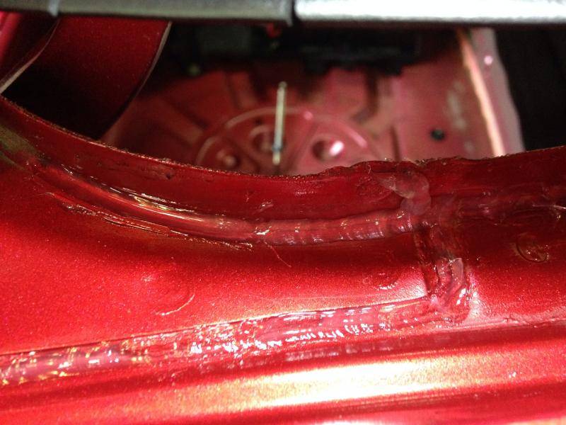

- Update #2 -
Alright, well, I really got into it today and checked everything out. I put clear RTV along the entire joint where the two sheet metal pieces come together, and about 8" along the bottom of where the seal bottoms out. I'll include a pic, I did it to both sides. I'm letting it cure, so I won't be able to test it till tomorrow...I'll cross my fingers and let you guys know. It does do a pretty good job of blending in, though, which is what I was hoping would happen.

The method you used to seal your trunk lid was pretty much what I did, only I used the clear windshield sealer which flows well so it would flow easily into the seal crevice. It cured my leak and from the sound of things this will cure yours.
