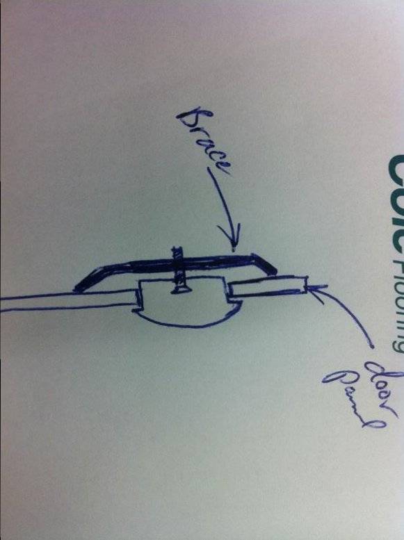

Me? Don't remember, honestly. I think I used a 1" hole saw bit to drill the hole (I cut the vinyl/leather (whatever it is on the door panel) with a utility knife, since I was afraid the hole saw bit would tear it up. Then I used a dremel to trim the opening wide enough to fit the "cup" that the tweeter sits in.
Thanks I want to flush mount some tweeters..but I have no experience in doing it..is there anything u did to keep the "cup" from moving

The cup has a brace that attaches via a bolt from the inside of the panel. I'll draw a quick pic of it.
