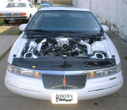

jeffery kline from new york did it on his 97 lsc. he had a twin turbo set up, but took it off for a blower. his name on the lincoln forums is LSCVIP.
My thing is there isnt enough room to turn around the headers to have mounts for the turbos without cutting out alot of stuff, maybe some one has more cash than brains(like the caddy owner) and will waste it on doing a TT Mark 8. I could maybe see a kit like the rear mounted turbo kit for the Vette. Either way it would be cool to see.

jeffs were mounted down low, under the motor, around the bottoms of both exhaust manifolds.
Those must have been pretty small turbos to fit.
Jeff said it wasn't worth the effort. The car was a beast but the turbos hung to low and AFAIK he never had it dial in 100% before getting rid of the turbos and going in another direction. The car has been off the road for a while while he's getting another combo together.

I'm still curious to know how that turbo Mark on youtube has been packaged - never could find any info on it.

Gene has a 96 LSC(with hids) with a twin turbo.
We spoke about putting a turbo on a street mark 8 and he said without even pausing, DONT DO IT.
now this is the guy that made a living out of putting Turbo's on all kinds of cars in the mid 80's and up until the mid 90's ish.
He said there is too much crap under the hood that would have to be either replace, relocation or eliminated all together.
Then he walked over to either mikes or my car and said.. "open the hood".
When we opened the hood Gene said.. "EVERYTHING, that is plastic"..
the underhood heat associated with a turbo will kill EVERYTHING...
Gene said either put a vortech or a procharger on it period...
