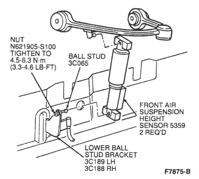

Here is a pic of the front suspension.....
It is relatively easy to get to the passenger side upper control arm than it is to get to the drivers side, mainly because the brake resevoir is it the way of the nut closest to the firewall on the drivers side. You will need either a 18MM wrench, or a 18MM crowsfoot attachment for a ratchet to remove the bolts on the upper control arm. If I remember correctly this is what I did to replace mine which I did it....

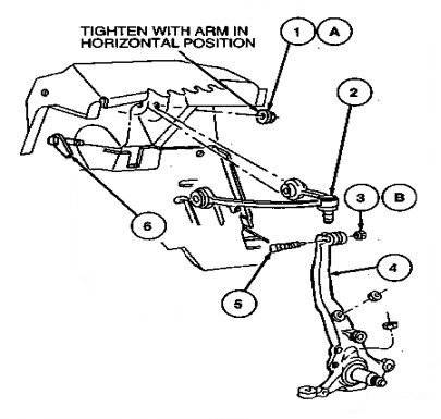

Here is another pic to help ya......
A - Tighten to 75-120 N-m (56-88 Lb-Ft)
B - Tighten to 68-92 N-m (50-68 Lb-Ft)
