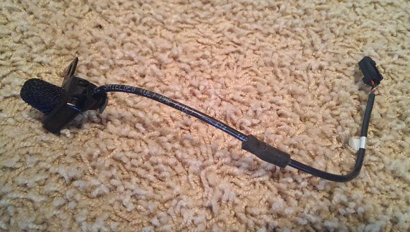

Okay, I have pulled out the factory microphone from the steering column. It's got a lead about 6" long and then a simple 2-pin connector:

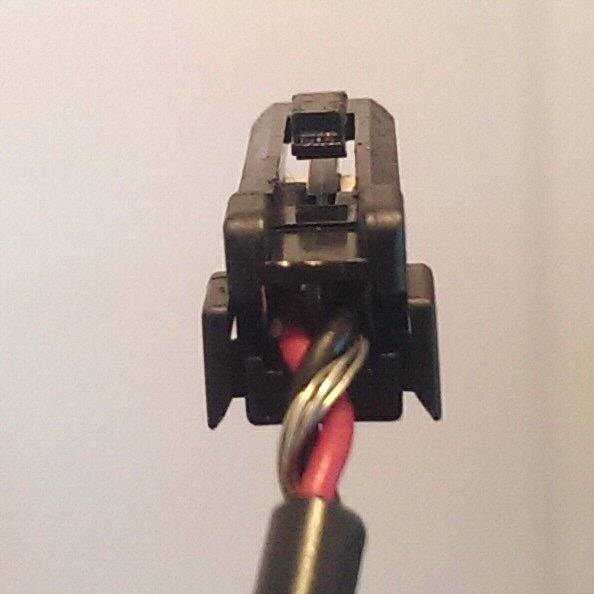

Pin 1 is red, and Pin 2 is black and what appears to be shield twisted together:
I wanted to test it out before cutting any factory wires, so I grabbed a stereo 1/8" to RCA patch cable, cut off the RCA plugs, stripped back the wires, and inserted the bare wires into the mic connector in the way it looks like they would go: Red wire from patch cable to red pin in mic, and white wire plus both shields to the black/shield pin in the connector. I verified with the continuity setting on a multimeter that the rings on the 1/8" plug connect through to the appropriate pins on the back of the connector. But when I plug the contraption into the mic jack for my computer to test, I get no audio.
What am I missing? The mic internals include a PCB that's a little larger than I would expect for a simple microphone. Maybe this needs to get power over the wire too?
