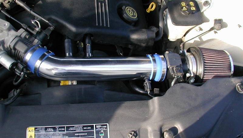

I might know a thing or two about making a custom Intake pipe.....

on that intakehoses.com site i dont see anything for connecting the MAF sensor to ?
I just bought a universal inter-cooler piping kit off of ebay(http://cgi.ebay.com/ebaymotors/CXRa...013QQitemZ230238704677QQrdZ1QQsspagenameZWDVW) and used a peice to fab up the intake. You can get polished aluminum or stainless steel tubing.
Can't remember what size I got, but I do remember that the tubing fit snuggly inside the MAF housing. It would also help to know a welder to put in some vent tubes. This leaves you with five peices of piping left over.... make a couple more to sell on e-bay to make your money back.
for the upstream side of the MAF you use a rubber coupler, for the filter side, you have to buy a MAF to filter adapter. I don't know how big an v6 MAF is but a V8 takes a 3.5" MAF adapter. I test fit the one I bought off Ebay for my Mountaineer back in the day and it fit. Then you need any cone filter of the same inner diameter. I think I paid $5 for that adapter on Ebay.
