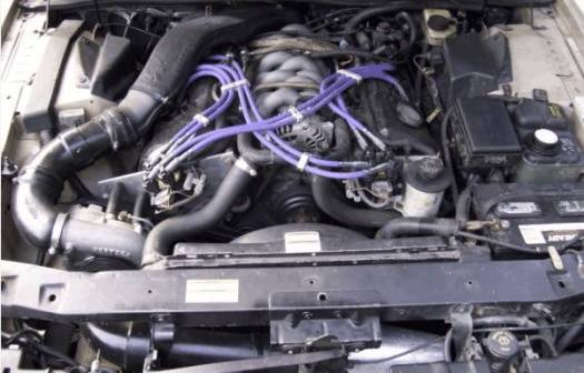

http://www.vortechsuperchargers.com/global_item.php?gik=663
Object moved
http://www.lincolnvscadillac.com/showthread.php?t=64139
Don Pfau's Mark...
If you are working with a Gen 2 I am pretty sure 99/01 Cobra discharge tube would work to hook up the Vortech. That just leaves you figuring out the Inlet section.

Believe you're right. Inlet wont be too killer to modify. Getting the head unit in and spaced seems to require the most work. Will be ditching the emissons equipment as well, and considering adding a set of Kooks.

If you go with the 99 c head motor I would run aftermarket rails and a regulator with the return port. They can be had for a reasonable price on the mustang forums.
I've read that the 96-98 vortech braket will work on the 99 front cover but have never tried it. If the braket works then all you need is a little intake tube work and your good.

97MarkJA-The bracket on the 96-98 does work on the 99's. Been a common knowledge discussion on a couple stang forums.
