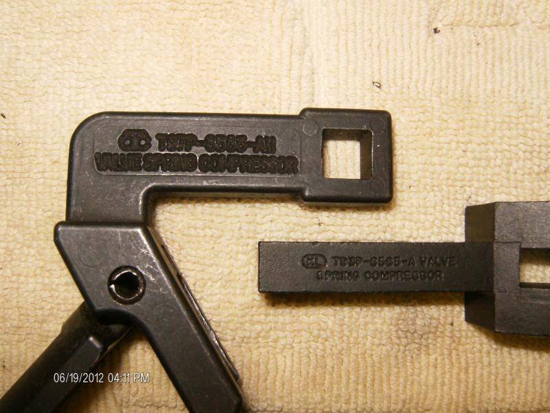

It may be worse than you think, you may actually need two tools. The intake and exhaust tools are different.

98 Cobra, but same difference. I know the OTC tool comes with both pieces. The one you can buy on summit will only work for the intake springs.

OTC
T97P-6565-AH (303-567) and T93P-6565-A (303-452).
AFAIK, the OTC 7928 will only work on the exhaust springs.
