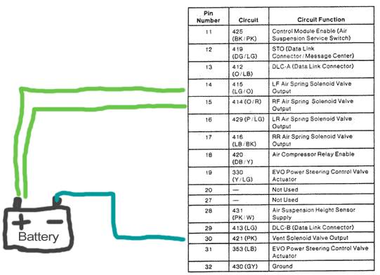

Hi Chris - Thank you for your effort! I have little idea of ​​the matter. Unfortunately, I understand very little. Is that picture of me right? Can I connect the cables to the front of the Lincoln comes up?
Translated with Google - sorry!Air suspension connector - Einzelsteuerung Kopie.jpg

is my sketch (drawing) true (correct)? I try several words. I try different words.
- How can I get the cable of the compressor? Where are the wires for the compressor?
- Voltage at 14 and 15 - to the positive pole of the battery? Positive battery cable at 14 and 15?
Ich hasse auch den Schee !
In your drawing you have - going to pin 30 to activate the compressor, I believe that should be pin 18. Or you can pull the passenger side wheel well and grab the wires directly at the compressor. It is mounted in the corner of the bumper. 12v to 14 & 15 I'm pretty sure but I will send a text to fordnut and ask him to post. I know he rewired his.

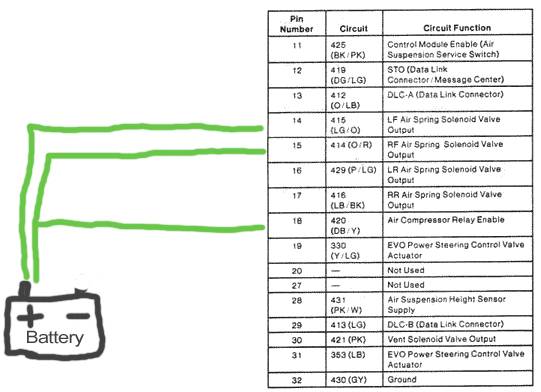

Ohh, thank you - I'm sure I misunderstood something. Thanks for the note. 18 also comes to the positive terminal of the battery?
Mark is completely lowered my front - I do not get a jack under the car. I can not lift the car with a jack.
