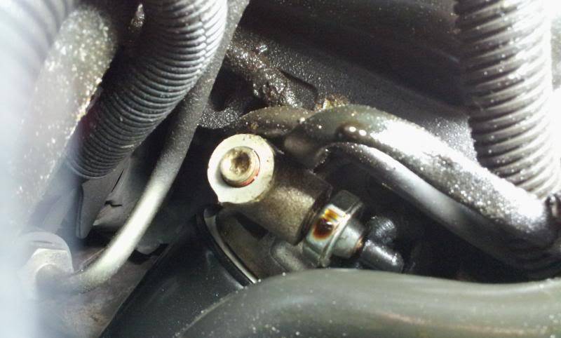

Here is what's leaking. Just got the part and waiting for it to cool again to swap it.
Made a damn mess under there.
Just noticed I placed this in the wrong thread lol.
