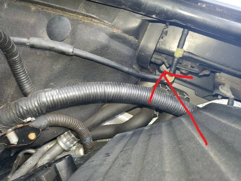

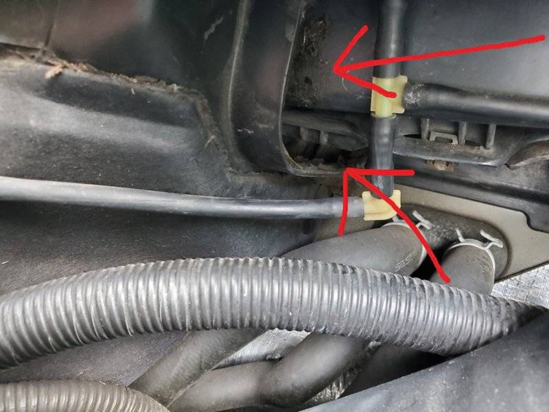

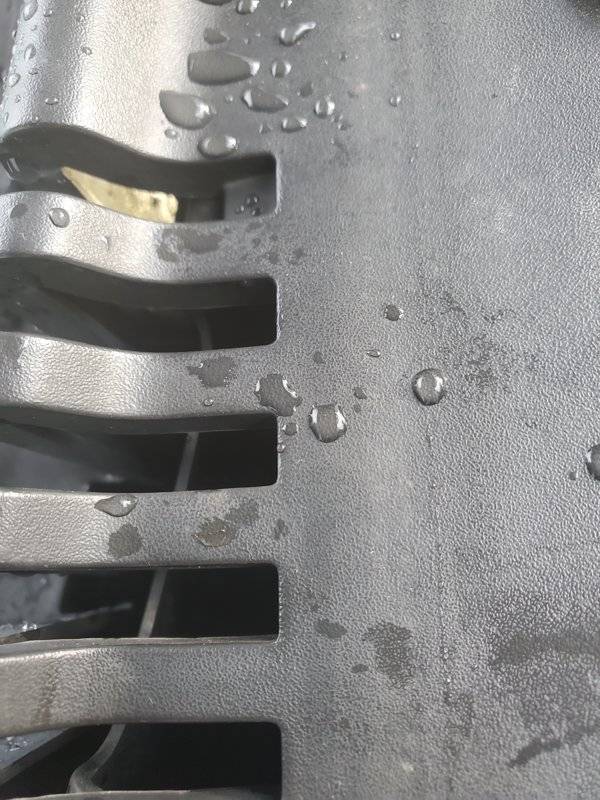

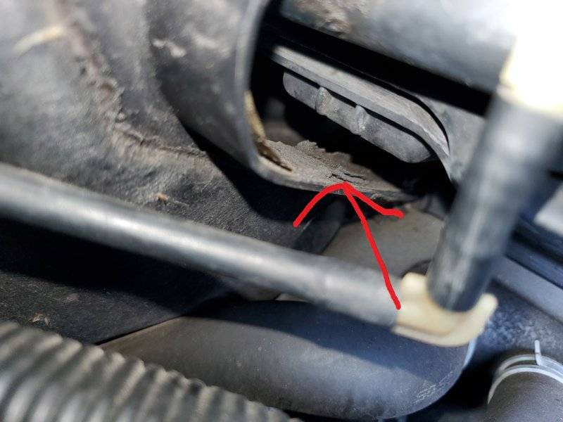

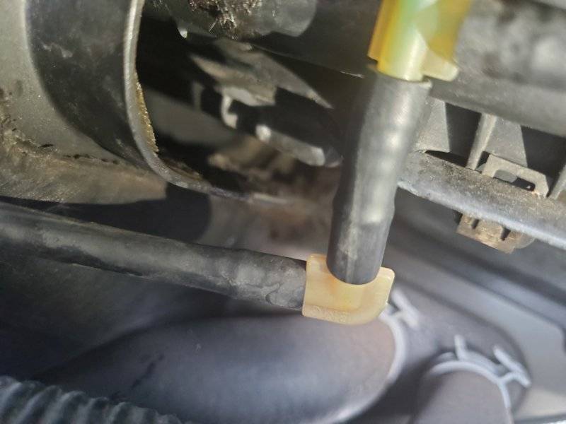

Got a misfire and saw that my passenger side coils were wet. I have zero leaks from the cowl/windshield seal or wiper seals and washer nozzles/hoses.
I realized that under the cowl where the airbox meets there is another foam seal? It looks to be missing and water can just pour onto the back wire by the coils. It is right under the gills on the cowl above the air box. You can see the where the foam was from the pic on the inside of the engine bay.
I realized that under the cowl where the airbox meets there is another foam seal? It looks to be missing and water can just pour onto the back wire by the coils. It is right under the gills on the cowl above the air box. You can see the where the foam was from the pic on the inside of the engine bay.View attachment 828572480 View attachment 828572481
I'm not seeing it having trouble getting a good look at what you're talking about ...more pics of a larger area would be cool ...this could be concerning for anyone who suffers the same situation ...thanks for posting ...should be easy to remedy this issue ...keep us posted what you plan to do for the fix....thanks nightshade
Hood to cowl seal is in great shape. I developed this with the coil cover on. Probably a great idea to replace the passenger side cover when doing COP's and VCG's since the seal on the cover obviously dried out and let just enough water in. Basically if you took a flashlight and shined it through this hole or the gills on the cowl you would see straight through. Water hits the two black hoses coming out the fire wall then drops around the cover and wire that goes to the coils.
