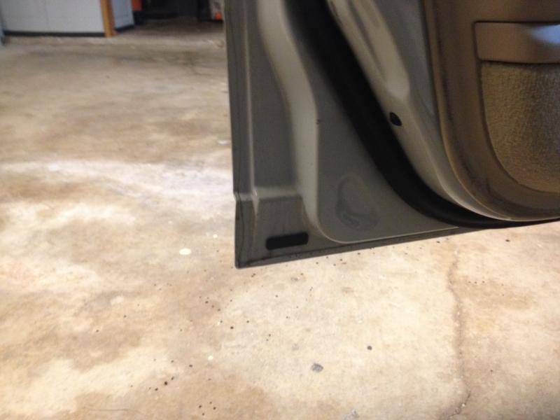

unbelievably, the LS has one or two flaws, if you open your door, at the bottom there is a seal to drain water from the door, its a little black plastic piece (========) you pop it off and the water will drain, you cant really help the water in the door, unless you made a modification to the weatherstrip

I had the water problem. It's a deal with the damn...DAMN system...there should be a lil plastic or rubber oval down on the bottum left corner of each door. Just remove it and dig out any dirt that might be clogged in the pathway. I have yet to put mine back in but I like it without them, no clogs or fogs :p

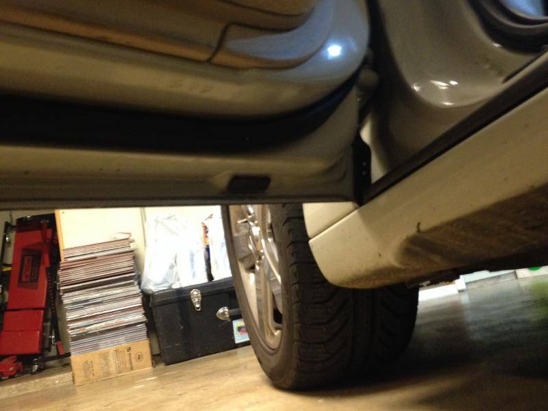

sorry bring up an old thread, but today i found out the front doors have 2 draining spots, one like i said before at the back part of the door at the bottom, and the better one to drain is located at the front of the door, its pretty hidden so you have to look under the door right towards the bottom hinge. if you pull that one off alot of water will come out!
(+++++++) - black plastic drain cover

can you maybe take a photo of this drain piece on the doors because I cannot seem to find it at all...so frustrating. thanks!
