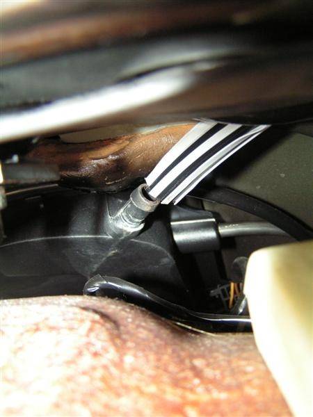

Maybe double check that they did not come off again? When I fixed mine I had to add a clamp as apparently the tubing shrinks over time and causes these to pull off the metal nipples. Others have had to add a splice and some more tubing to connect it.
Here is a great picture from a long shut down forum. Very hard to see the tubes and nipples and you don't want to take anything apart unless you need too!
Check both front drain holes along the pinch weld seams near the front jacking locations. I bet a service tech mistakingly tried to lift the vehicle at the wrong location and crushed or pinched one of those front drain holes or corrosion or debris may have blocked them. You can check if they're draining ok by pouring some water at the front corners of the sunroof and seeing if it drains ok at those front drain holes. Yes, a plugged front drain hole will cause water to pool in one of the rear foot wells. Those pinch welds are known for corrosion as well...so after locating the drain holes and making sure they clear, you may want to saturate the pinch welds with PB Blaster Surface Shield or Fluid Film.
