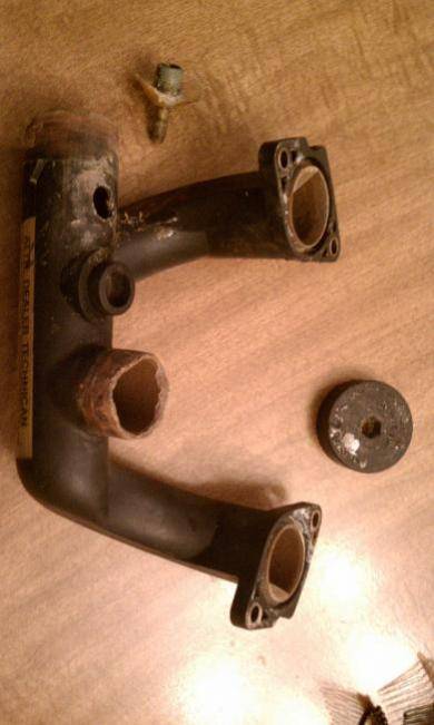

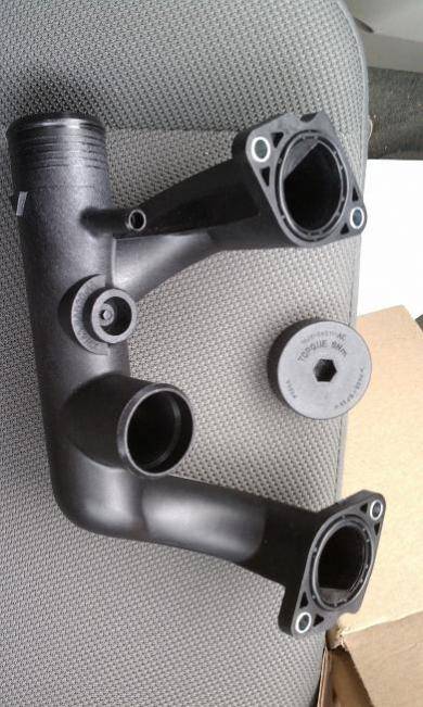

Like many of you, I've had a lot of trouble with failing parts on my LS. Recently I fought with the cooling system and with some help from many here on this forum, I've found helpful hints and similar stories.
I thought I would share some pictures of my failing Water Outlet Tube and Thermostat Housing for future reference. Included are the part numbers from Fordparts.com and alternative Jaguar parts from Rockauto.com
By the way, 2000 Lincoln LS 3.9 V8
Wateroutlet Tube: Part # 8A520
Link: http://www.fordparts.com/Commerce/PartDetail.aspx?n=PUtl2skZX81GgA%2fPu5RcOA%3d%3d&id=153722286&m=2&search=true&year=2000&make=Lincoln&model=LS
Jaguar Thermostat Housing: Rockauto.com
Link: http://www.rockauto.com/catalog/moreinfo.php?pk=1399057
