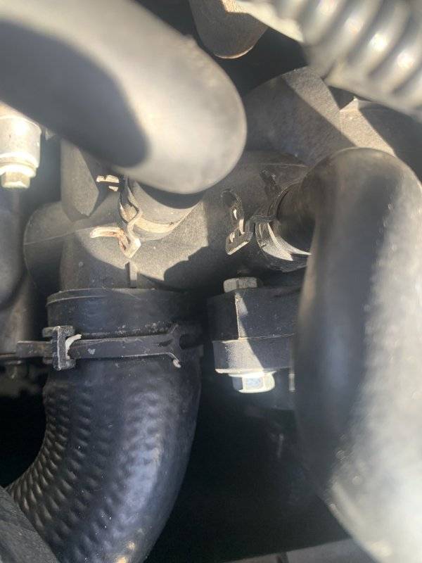

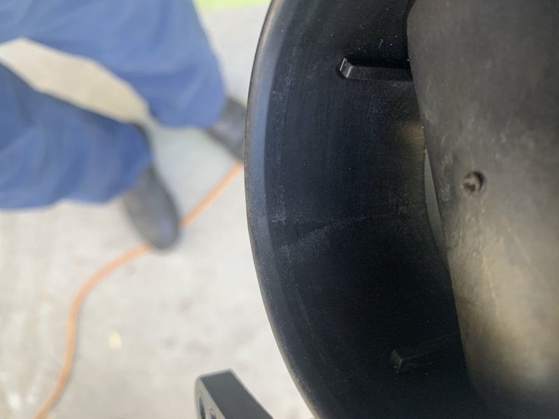

Now, I have discovered the true source of my issue. As I was assembling parts, I see this slight crack in my cross pipe. Ugh! This only has 25-30k miles on it!
Fortunately, I have a spare that had one of the T-stat thread inserts come loose. I have epoxied it in and will use a longer screw with a nut on the back side to ensure it doesn’t come loose.
These are both Motorcraft parts. The issue is also that some of these parts have been sitting around for 10-20 years aging.

Thanks! Of course, when I went to torque the other two T-stat bolts, those inserts gave and had to epoxy those.
I also ordered a new one from FPG.
This is my third Motorcraft outlet cross pipe.

The good news is that I managed to get it to work! The epoxy did NOT hold. What I was able to do was use slightly longer screws and put a small nut on the opposite side. It wasn’t easy finding nuts in my stash that would clear in the back. Once I was able to get the nut on and tight on the back, I could torque them to 89 in/lb.
After an efficient bleed, we are back in business.
Here’s a picture of the insert fix…this is the top left bolt if looking at the front of the T-stat housing.
