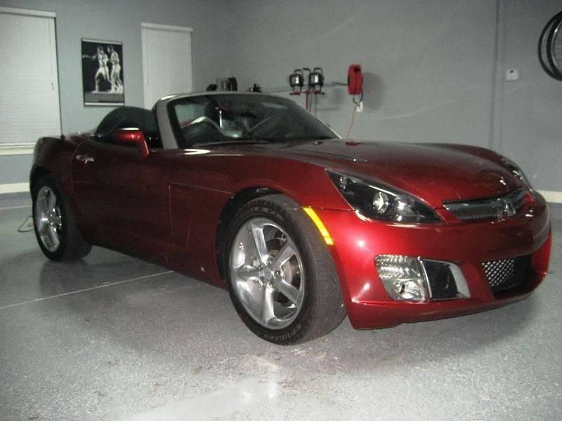

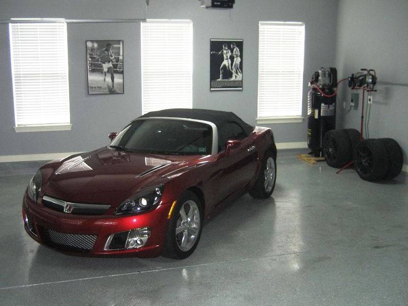

Here is what I started with:

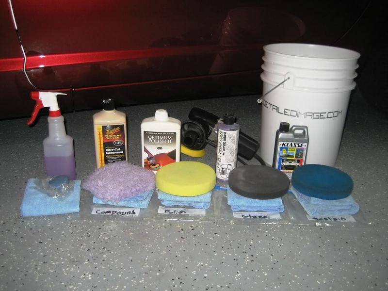

This is what I worked with:

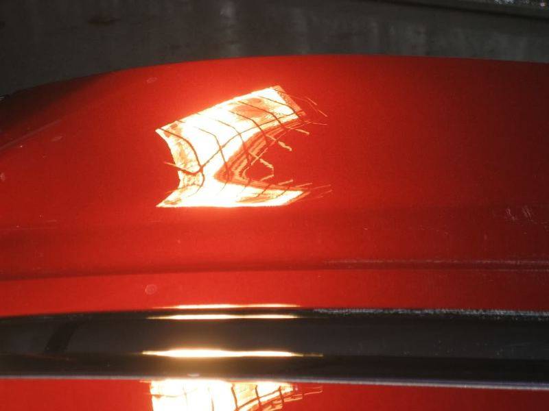

The first step was a complete claybar of everthing, including lights, glass, etc.:

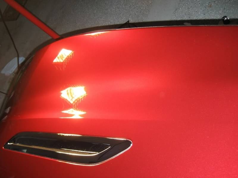

This is after compounding with M105:

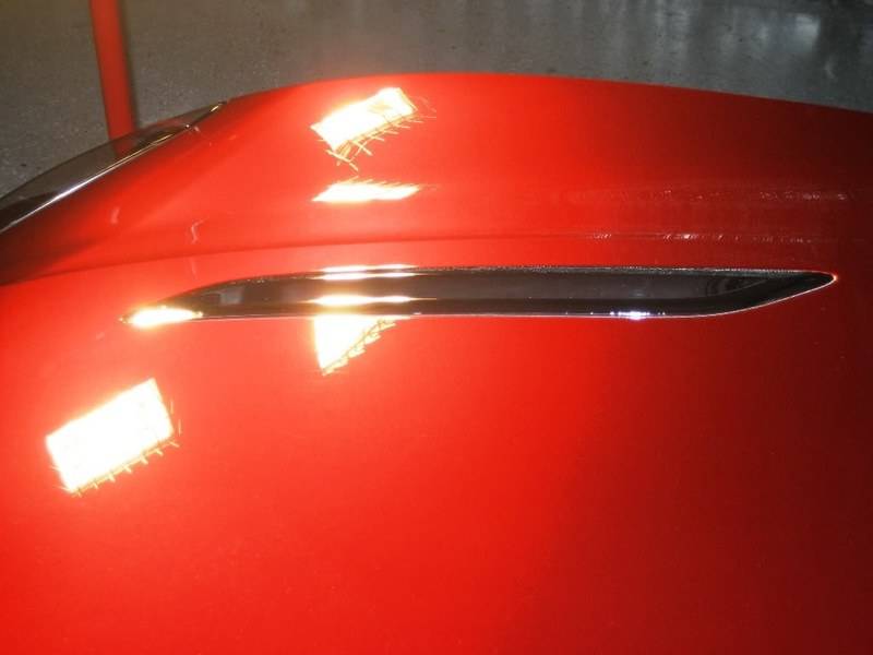

Then after the Optimum Polish:
The final step before sealant was the Glaze:

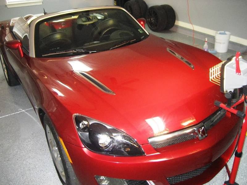

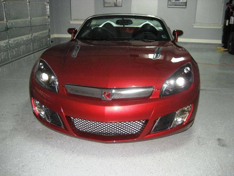

Again, leaving my picture-taking skills out of it, the finished product:

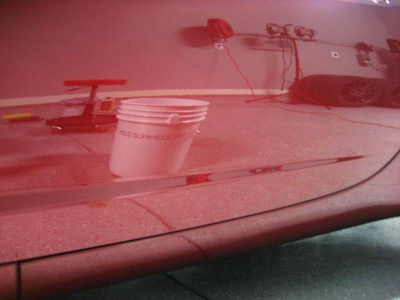

I did my best to capture the depth of the paint in this final picture, although limited lighting and a point-and-shoot camera probably limits the effect:
If you look closely you can actually read the bucket. Not bad for a weekend of effort! :D
Looking good! Thank you for the write up and I like your plan for tackling projects during that down time for you. Making time for projects is the only way projects get done. My only suggestion is the yellow pad is probably a bit too aggressive for the Optimum Polish II. I normally would use a white or tangerine pad, while others could be used. The yellow pad is one of the most aggressive pads we carry. If you use the white pad next time I think you'll notice slightly less haze in the surface and maybe just a bit more optical clarity. Certainly this is not a guaranteed correct adjustment, but just a suggestion based on my experiences.

You are probably right. I debated about using orange, white, or yellow for the second step. Since I was coming right off of the M105 with wool, I figured I would try it with yellow and feather it out. Working a little harder at first with the orange or even white may have finished out just a touch better, but the glaze helps even things out.
Finishing the garage was the "big project" from last year, complete with heater! :cool: The dream is to finish it off with a movable lift for the spot along the wall...perhaps next winter.
